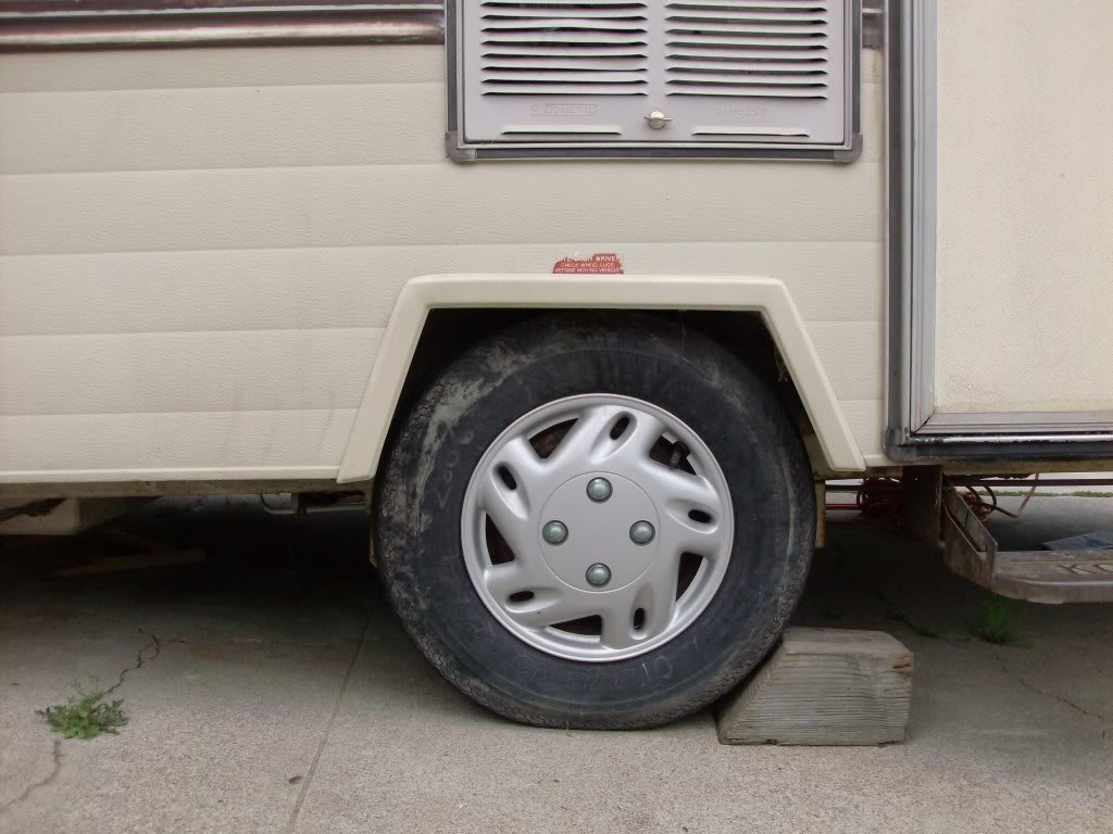

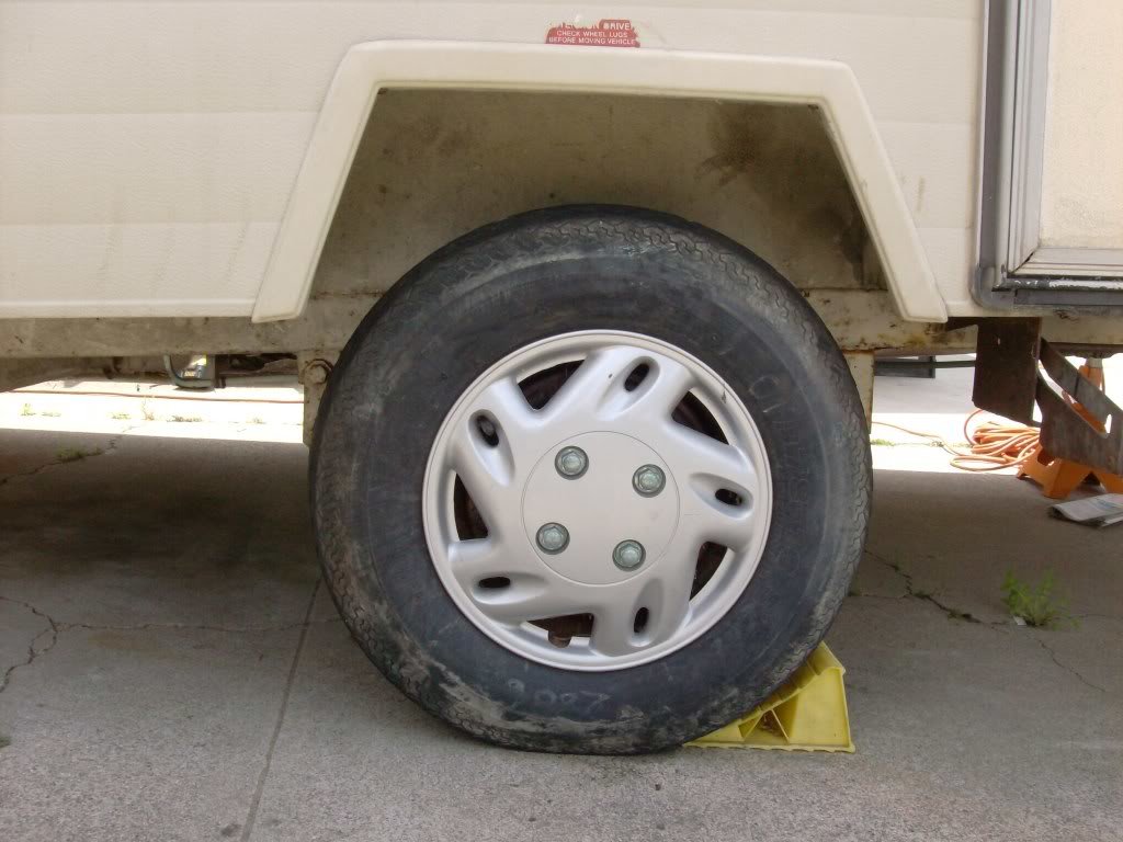

    I lifted my travel trailer ~4" by flipping the axle.
    Older trailers had shorter tongue heights because back in the day, trucks had lower hitches. Now, trucks have higher hitches, and on top of that, I have a 3" lift. I didn't want a 6" drop hitch ball, so I lifted the trailer to I only needed a 2" drop ball. So far its been holding up great!
  11. Jul 14, 2010 at 10:34 AM
    MJonaGS32
    MJonaGS32 MJ on a GS
    Apr 14, 2009
    #15949
    12,415
    MJ
    SF Bay Area (East)
    07 LT 4x4 DCSB 6spd Vagabond
    Drifter wedge camper, Dual battery, OBA, ARB locker, 4.56 gears
    before
    after
