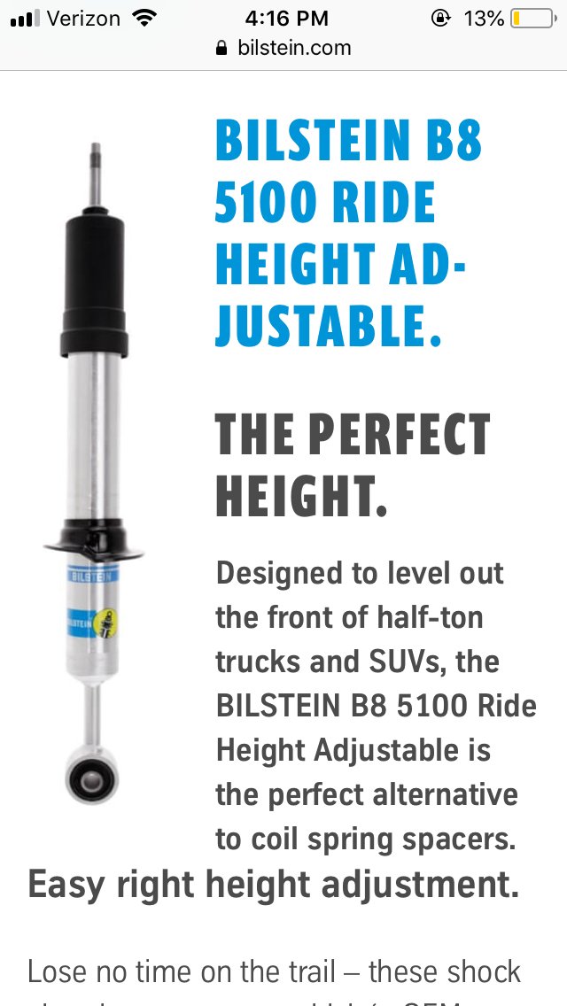

    so this is what I found from the bilstein site , these shocks give you lift simply because the coils , (springs) are set higher on the shock hence the spring is what’s lifting ur truck , and that’s the difference between adjustable shocks is that you can adjust where the coil seats on them correct ? That’s all I got man appreciate the help 32BF0749-89AF-4F11-B371-7B82405F449B.jpg

    So with this kit I wouldn’t have to buy new springs . Just use the current ones I already have

    Guy above explained it well^

    https://bilsteinlifts.com/shop/toyo...-lifts/toytec-eibach-front-coil-lift-springs/
    These are the coils that I'm using. They give 1.6-3 inches of lift depending on the coil setting you have on the 5100. These are made to hold more weight, but the stock coils should get you what you want if adjusted on the 5100s
