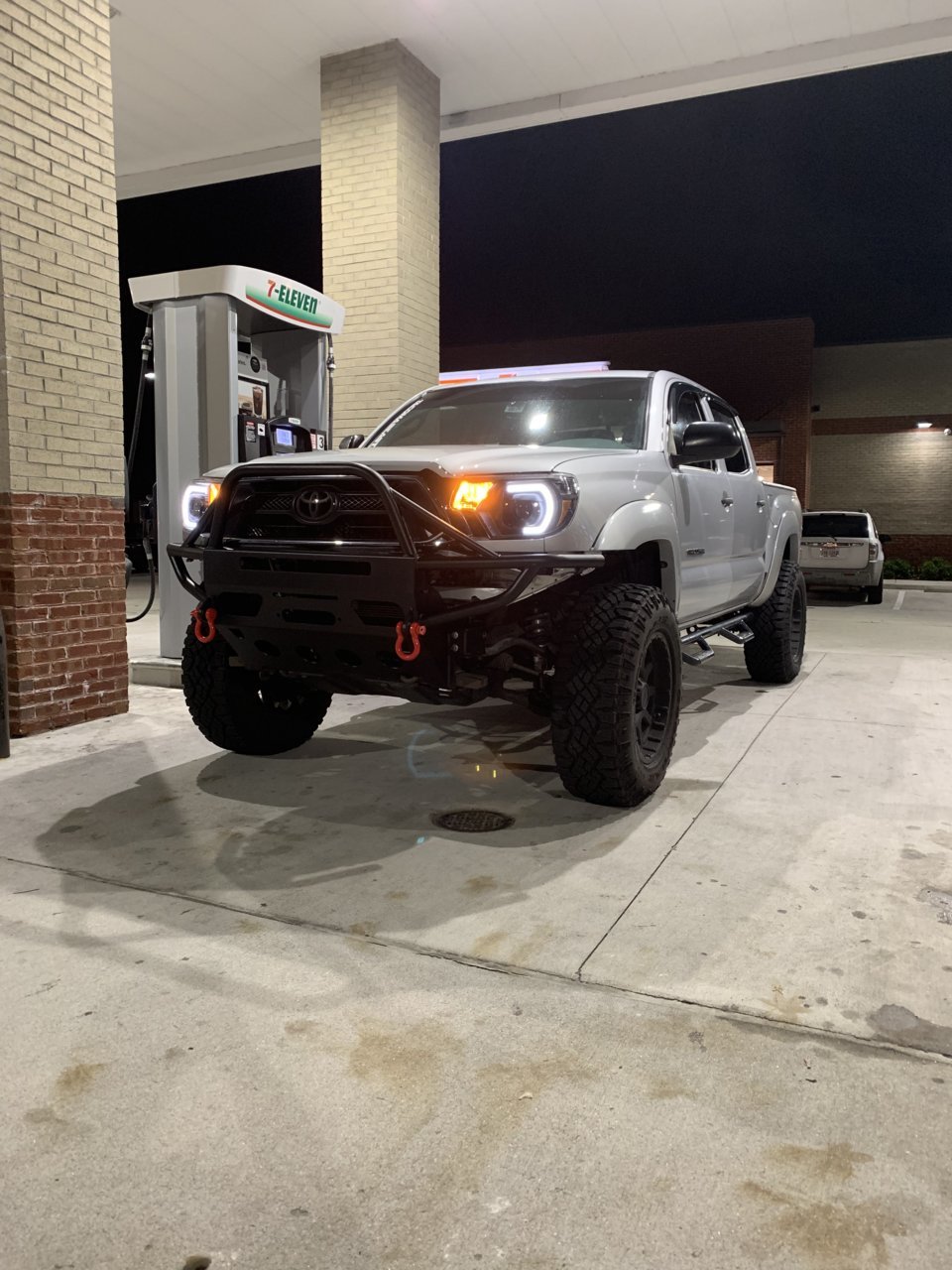

    nice truck... I can't tell by pic, does that bumper have winch mount? How much was it? I currently have HWMS bumper but want to change to one like yours without braking the bank.

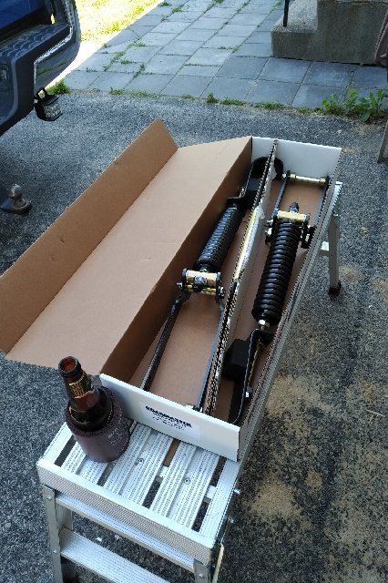

    I installed an RMAS kit(see post $207) and gained 1.5" lift in the rear.

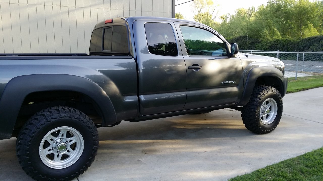

    I ran the 5100's at 1.5" and a four leaf pack for a few years, mostly for the leveling affect, and it ran fine.Truck_1.jpg
