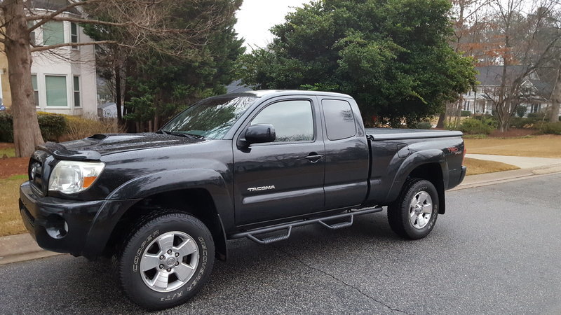

    I need some advice from someone with experience... I have an '05 Tacoma TRD Sport 4x4 access cab with 92k miles on it. It was stock, never modified - I wanted to improve the stance/looks and level it out without spending a lot of money on it. I installed Toy-Tec AAL in the rear and got about 2" of lift - I had brand new leaf springs from Toyota thanks to the recall. I tow a trailer and boat occasionally, and figured this was smarter than blocks - I didn't install new shocks, still the stock TRD Bilstein 4600's all around.
    I wanted to level the front just a little, so I installed 1 1/4" coil spacers, leaving the springs and shocks alone. Shocks are all in good shape still, 92k isn't that many miles, although I would probably improve the ride by replacing the shocks. I ended up with right around 2" of lift in front, so there's still a rake to the truck, but it looks much better. I've got the stock wheels/tires 265/65R17 and I will probably go to 265/70R17 when these wear out. Nothing major, don't plan to off-road other than hunting trails.
    So, measuring from the center of the wheel, front drivers side is 22", pass side is 22 1/2" (didn't read about the lean until it was too late). Rear is 23 1/2" on both sides. My problem is that even at 22" and 22 1/2" in front, I immediately got the needle bearing vibration/noise - not bad, but it's there. If I switch to 4-high the noise disappears immediately. I was hoping that since I was still under 23" hub-to-fender, I'd be ok. If I have to, I'll do the ECGS bushing to correct this, but it would be a pain.
    Does anyone know if installing the Bilstein 5100 adjustable shocks and setting them at 1.75" will bring it down enough to solve the needle bearing problem? I know the 5100's aren't that different from my stock shocks, but I put them on my F150 and have been very pleased with the ride quality. Plus, even though my stock 4600's are not leaking or bouncing, and ride is still good, shocks don't last forever, and at 92k miles, probably need to be replaced. Plus, I can install the 1/4" spacer to eliminate the drivers side lean that I didn't know I had - I should have paid more attention to the before measurements!
