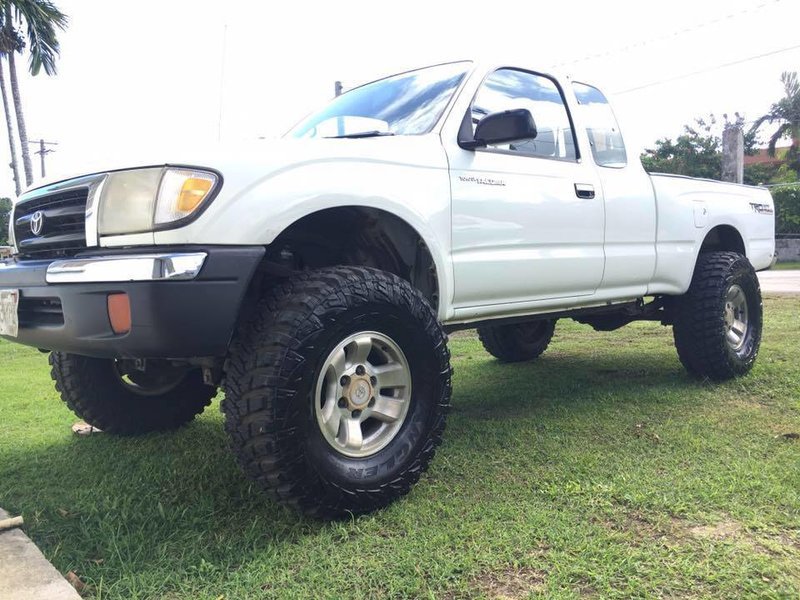

    I have a 98 Tacoma on a 3 inch leveling kit and I'm running 33's. Any suggestions as to how I can run bigger tires? (37's, 40's, etc)

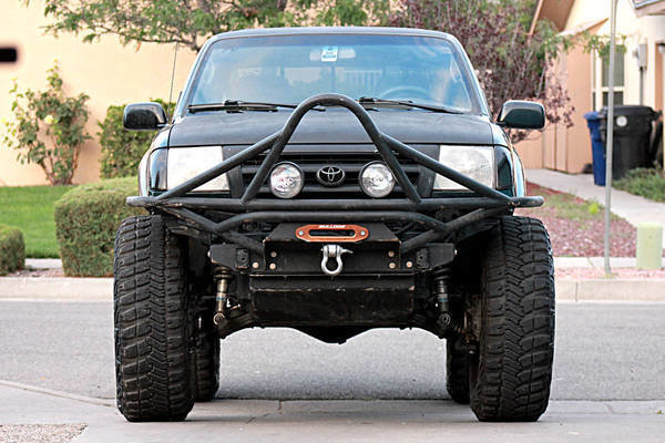

    Grab a big as hammer and a saw and fit as big as you want without any lift. Id recommend that over an ugly and unsafe 3" bl.
    Dont forget with that size tire regearing is basically required and youl be putting way more strain on your front end.
    Heres 3" co lift with 37s.

    damn lol. how much did you have to cut to fit those!?

    Not my truck but he cut alot... Like a few inches into the cab alot lol.
