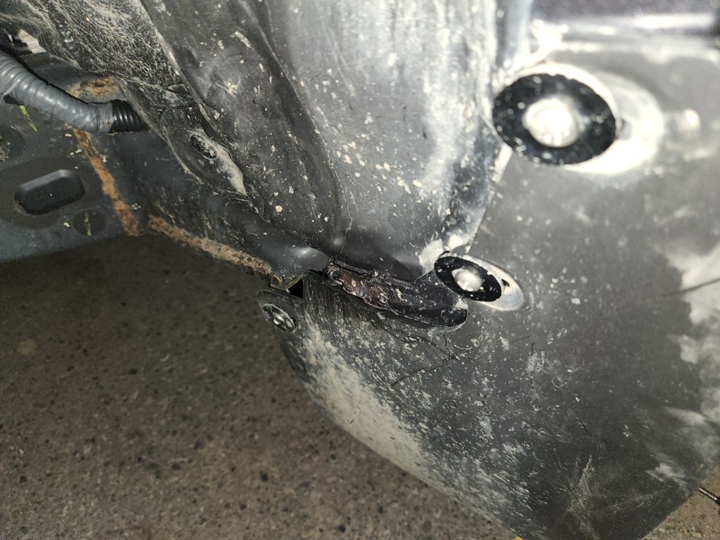

    Looks like alot of speculation in here but no real world experience so far.
    I ran a 17x9 +1 with a 285/70r17 duratracs a few years ago. No cmc minor trimming and still had mudflaps.
    Lift varied anywhere from 3-2". Added a bumper and winch that dropped the lift a bit later on. Bolth spc and dirt king uca's have been used. Dirt kings are still on spc's are in the trash.
    Never had a cmc with this set up. Was able to run rokblokz mud flaps with minor rubbing off road. High caster alignment was 100% necessary. The +25 will likely rub the uca and possibly the frame, based off what I saw with a +1. +10 to 0 is the sweet spot for ideal clearance with a 285.
    You can see where it would touch the mud flap but never hit the cab mount. I did move the front fender liner forward just a touch aswell.
    Yes it takes some extra work to fit and you bet you will notice the extra weight but a 285 is not a bad size for these trucks. If you want simplicity and the ability to use your existing wheels the 255/80r17 is a better fit. (I don't know if there is a 255/85r16 for a true skinny 33)
