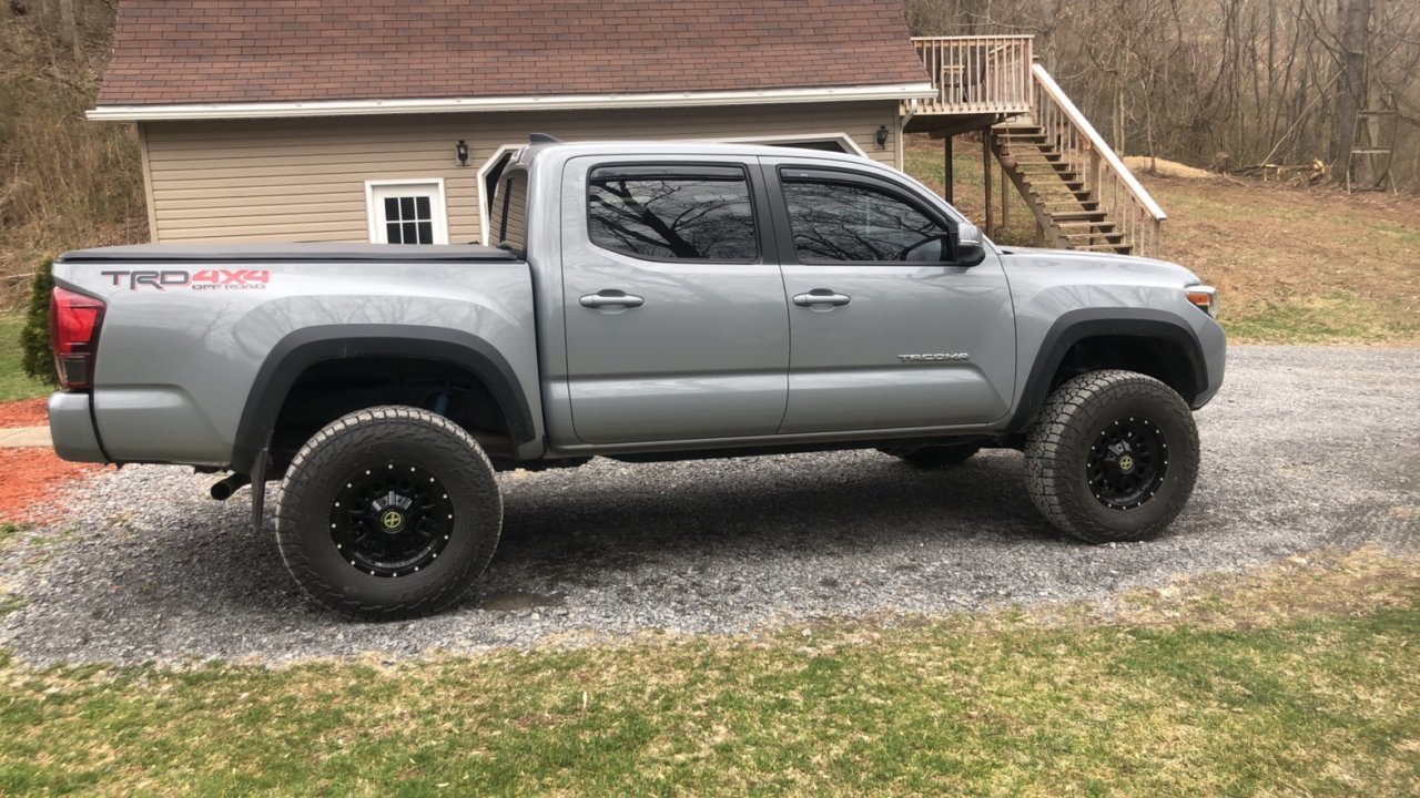

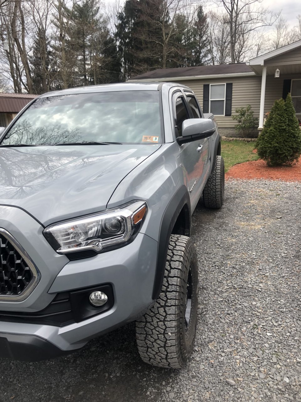

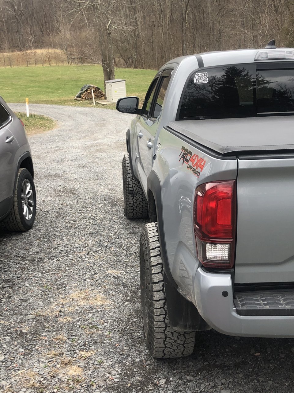

    Just posting pictures of my truck to help others out when upgrading. I have a 2018 Trd off road I put a supreme suspension brand leveling kit on it it’s a 3” front spacer and 2” rear block. I have 1.5” wheel spacers with 16”x8 wheels with a -6 offset. Also running 285/75/16 falken wildpeak AT3w tires. Truck rides great can’t complain the suspension is still great haven’t taken it off roading but if i did i wouldn’t do anything drastic. The tires rub just a hair at full lock but it’s not gonna rip the fenders off haha hope this all helps someone.

    The leveling kit was $200
    Tires $235 per tire including mount and balance.
    Wheels were $650
    Spacers were $90. 12mmx1.5 hubcentric
    So I had about $2,200 in everything including pay someone to put the leveling kit on and pay for a alignment
