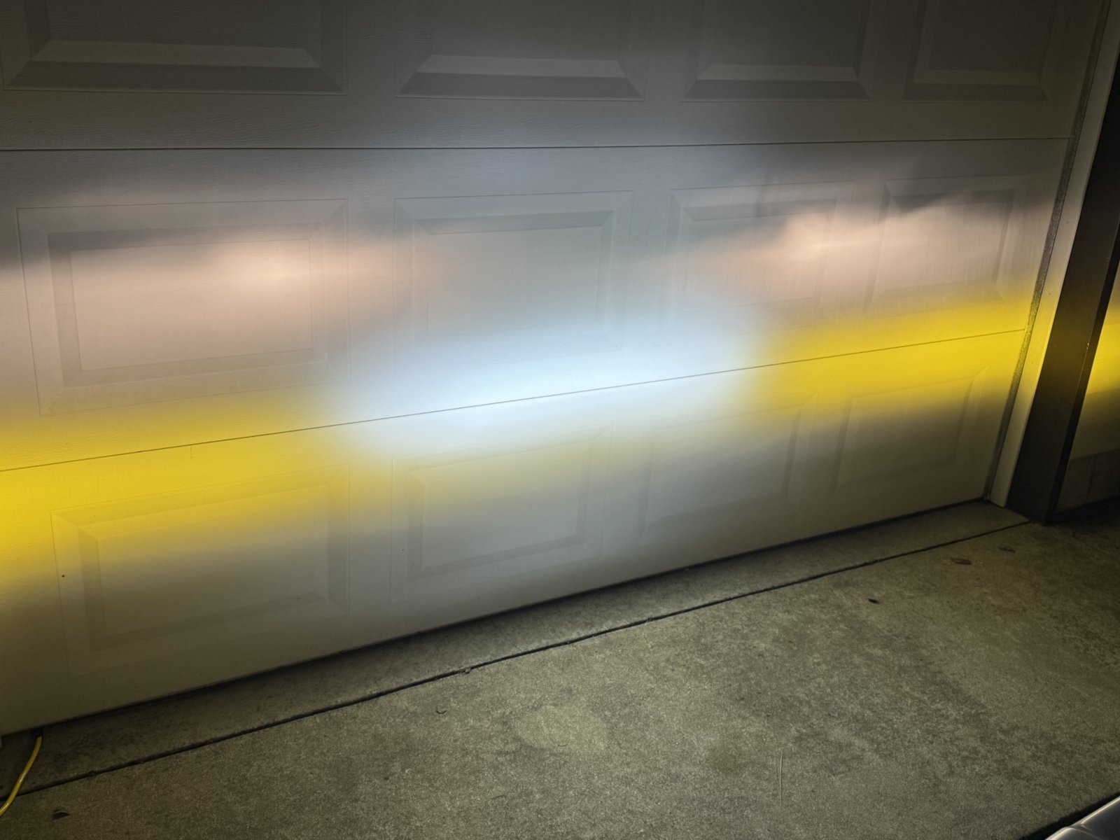

    I just installed a DD driving bar how does my pattern look ? Do I need to go up or down or is it fine thanks

    And if I could add some advice, get one of the "angle finder" apps for your phone. Then find a dead level spot to park your truck. (Check it with the app.) Next, aim the light bar to be dead level with the phone. Lock it down and you're done.
