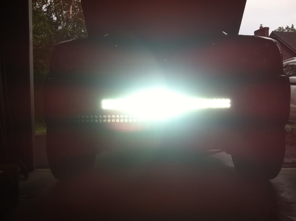

    I'm in the process of mounting mine in the lower grill but I have the okled 30" combo light with flood pattern on the outside, so being so far in the grill didn't look too good for light output so I cut out the lower grill and fabbed up a couple small L shaped brackets to attach to the vertical bars inside the grill and brought the light out flush with the bumper. I'll take a few pictures of the brackets and the install. Also have the wiring harness from then and have to say it all seems light great quality. Excellent customer service too!

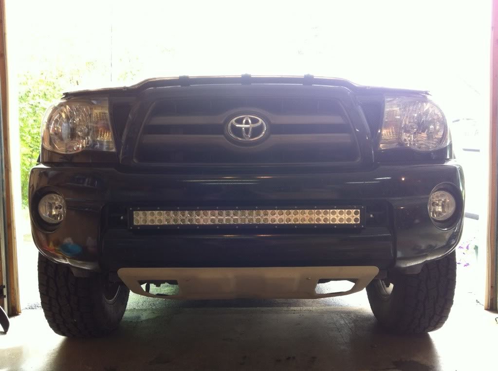

    Here's a couple pics, I used some angle bar, 1.5" x 1/8" thick, 2.5 inches long. Placed on the inner vertical rain and marked out the 2 holes as drilled them out and bolted them on then took the bar and centered it and marked it, drilled a few more holes and box liner sprayed the brackets, and reassembled. I think it turned out pretty good!

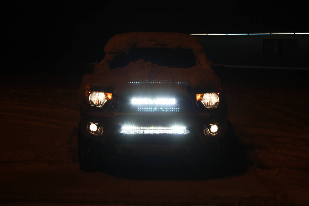

    As for cooling, should have no trouble, have a set of 20" double row Rigid lights behind my upper grill and a single 30" in my lower.
    I have had no problems even while towing a trailer this summer.

    Good to see people still using this. Mine is still going strong. I do plan to swap to a 30" bar in the future. I may do the L bracket up to push the light out like a few have done here.

    I measured from the middle of crash can to crash can and its roughly 32 to 33 inches so in your opinion do you think it would work if I got a 32 inch light bar and bolt it right there? I'm worried about it being to tall but it should be same stance as your angle iron since its resting on the crash cans evenly
