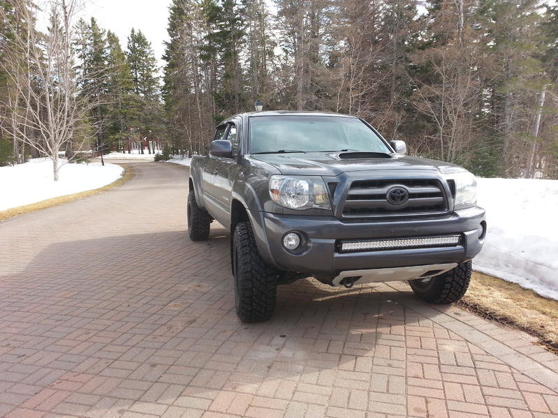

    How does everyone wire there light bars? I just installed a 36" and the wiring kit I got is made to connect directly to the battery but I don't like that its always live, I'd like that wen my key is off that everything would be really off.

    I'll pm you later

    looks good. any info on the bar?
    I have been trying to find a 36" in amber with no luck anywhere.. :pout:
