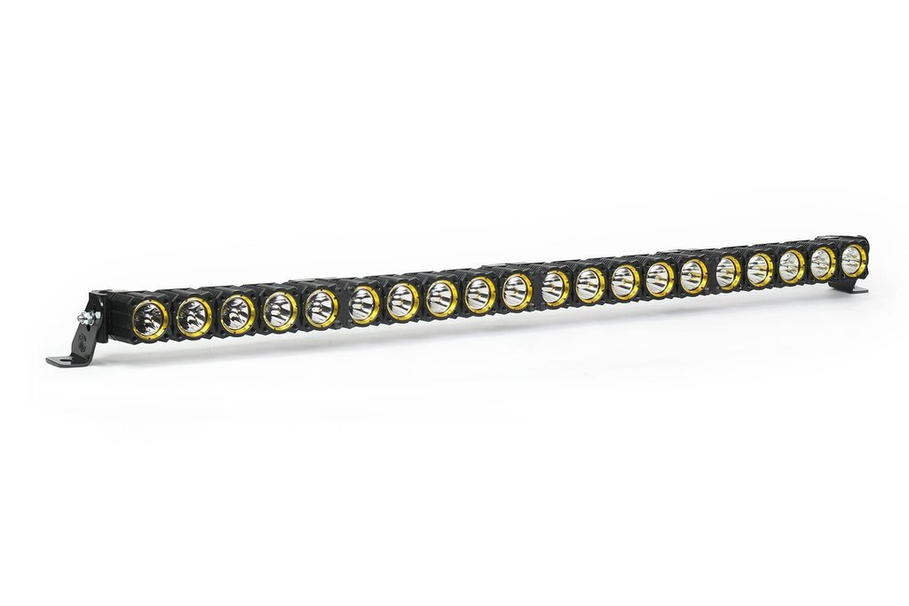

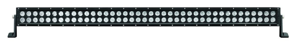

    We have plenty of options for you that could hit in a couple of different price ranges that will still give you the highest quality that you're looking for. Let me try and break it down for you based off of your area zones. I also put three red stars (***) next to what I would say are your best options depending on your price range. For your front and rear facing bars that you want in 54" and 24", we can or you can custom build the FLEX series to your desired length so that it matches very closely to that rather than going with a 50" and a 20".
    EDIT: Oh, and for your switch panel, check out @Iggy 's one that goes in the spot you're thinking and uses standard carling rocker switches. That's what I use in my 2010 and I love it. All of our lights I linked below come with switches but that doesn't mean you can't modify them to your liking. Linky here
    Front:
    • These three options start at the lowest pricing and work their way up. Our C-Series is our closest offering to a standard light bar. Our FLEX series is our highest performance short-mid range light bar and offers an incredible amount of light control due to deeper reflectors and other design features. These are also unique modular and can be simply built to absolutely any length you'd like by yourself or by us. Our Pro6 line will give you the furthest light throw, but I would not recommend this for you as it should really be accompanied with a short-mid range solution as well such as the C-Series or FLEX.
    • ***C-Series 50" Bar - 27,000 lumens | 3,200 lux | 1,131 m distance | $529.99
    • ***FLEX Series 50" Bar - 24,357 lumens | 4,400 lux | 1,327 m distance | $2,047.99
    • Pro6 50" Tacoma Specific Bar - 18,400 lumens | 6,700 lux | 1,637 m distance| $2,107.99
    Side:
    • The differences among the C-Series and FLEX remains as stated above. I think your best bet here would actually be one or two pods on each side so you can adjust the lights to illuminate whatever you'd like depending on the situation. To light up base camp, you want a flood pattern ideally or a spread pattern as a second choice.
    • C-Series 6" Bar - 3,240 lm | 230 lx | 303 m | $152.99 each
    • ***C-Series Flood pattern pods (x2) - 1,080 lm | 55 lx | 148 m | $164.99 for two
    • Single FLEX spread pattern lights (x2) - 975 lm | 170 lx | 261 m | $252.99 for two
    Rear:
    Estimated total with C-Series 50" front, two pods per side, rear facing 20" bar, and two rear facing pods: $1,277.95
    Estimated total with the FLEX 50-54" front, two pods per side, rear facing 20" bar, and two rear facing pods: $2,795.95
    More info on C-Series can be found here!
    More info on FLEX Series can be found here!
    C-Series Example:
    FLEX Series Example:
