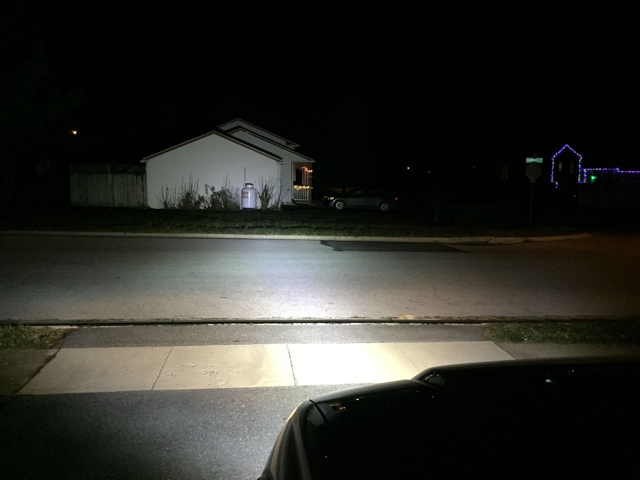

    So here’s the difference. The top one is the $250 dollar caliraised 32 inch bar on my Tacoma. The second is the $150 dollar mictunning 32” bar from Amazon. On the Caliraised bar everything was extremely good quality. From the bar to the brackets. The mictunning bar was okay. And I had to make my own brackets. Took 3 times as long to install. I could not be happier with the Caliraised stuff. It is at least twice as bright if not three times. Spend the extra money and get the good stuff.
    Disclaimer: These pictures were taken over a year apart on 2 different vehicles using 2 different cell phone cameras. Top picture is Caliraised 5d 32” light bar on a 2” lifted 2016 Tacoma using Caliraised stealth mount brackets. Bottom picture is Mictunning 32” dual row led bar mounted in front lower bumper of a 3” lifted 2003 4Runner. Both vehicles are not parked in exactly the same spot in driveway and both bars are not adjusted to the same orientation. Light output between bars is dramatically different.

    Would help the comparison if the lights were actually adjusted the same...
