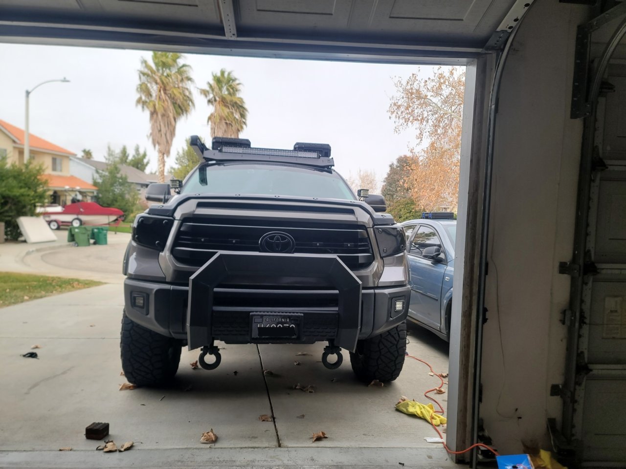

    tl;dr : Got a new Light Bar. Can I tap into the Wiring Harness for my Pod Lights without blowing something up?
    So about 2 years ago I purchased a Pod Light kit from Cali Raised (https://caliraisedled.com/products/side-projecting-led-pods-sold-as-pair) came with this Harness (https://caliraisedled.com/products/wiring-harness-dual-leg) Installed it, has been great since. Recently I purchased a 42" Dual Row bar from them as well (https://caliraisedled.com/products/42-dual-row-5d-optic-osram-led-bar). As I don't plan to ever use just 1 but instead both at the same time I'm curious if I can tap into my existing wiring harness and use the same switch to power on both without issue?
    I'm still fairly an amateur when it comes down to this sort of stuff. Figured I'd post here if anyone is familiar with my equipment and willing to share some insight.
    Thanks.

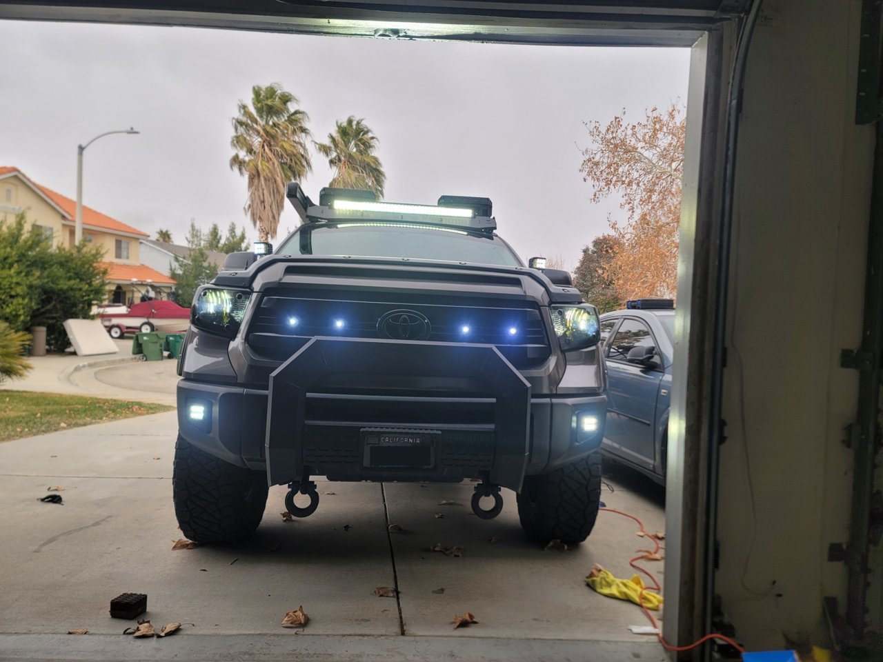

    Thanks much for all the tips. @destin_meeks I did not think about wiring it so it would trigger both relays thanks for the idea, guess I just wanted to avoid adding more wires to my engine hoping I could tap into my existing harness. Used the supplied harness the bar came with. Turned out great. Can't wait for the sun to go down see how bright the bar truly is
