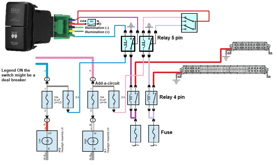

    So looking at this the smaller light bars would be for Amber and the larger on is for white. This works for simplicity but it uses a on off on rocker switch which was the issue to begin with. I couldn't find any 3way rockers that keep an oem look like the ch4x4 on off switches do.

    There is a China one that has 2 in 1...

    Damn wish I found those a couple weeks ago when I started this project. To bad I all ready have the switches and made the wiring for all this.
