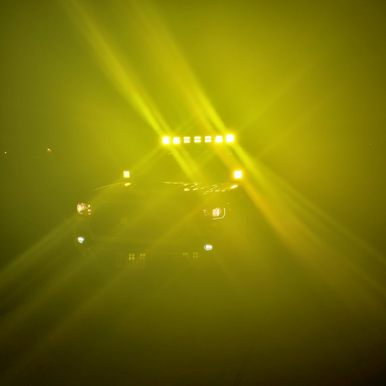

    I run a roof rack light bar with 360 degree lighting on all four sides, more in the front, with a few amber pods on the front ends of the bar. Would recommend, good addition for more storage if you need and for lighting/looks.

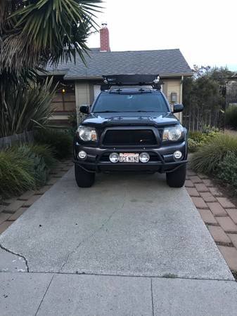

    I have a light bar that I bought rather than a heavy front bumper. It took a dear at 30 the other day, and if its head hadn't hit my headlight, I would have had no damage. Bumper is fine, just broke some tabs on the passenger headlight. I think a light bar can be more than a light bar.

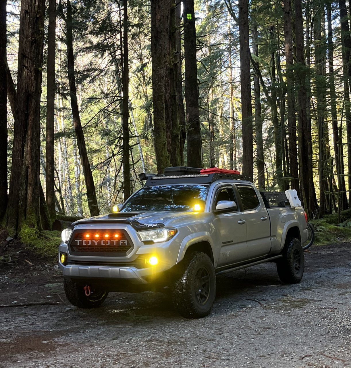

    I have a cali raised light bar up top, white light, works great on a dark night without rain, a bit reflective off the hood, but not bad!! Both ditch lights and fogs are diode dynamic, in amber, they are awesome!! Eventually when a get a new bumper, white light bar goes in there!!

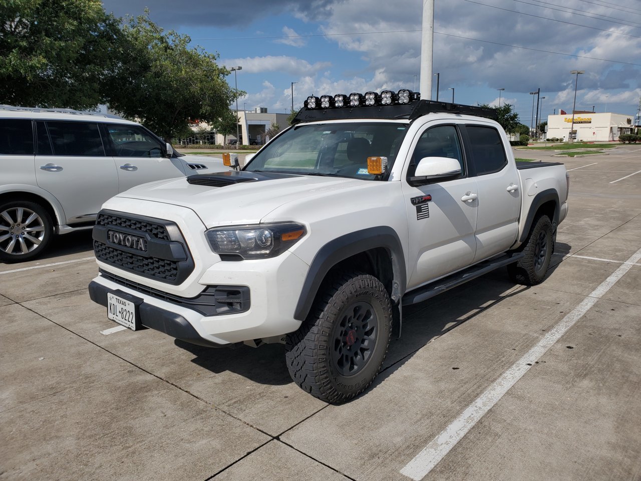

    Running Baja Linkables on the roof and Ridged D-XLs as ditch lights. They're all white but I have amber lens covers so I can switch between the two.

    Thai set up looks awesome but is it as effective as white ditch lights up top
    I have the yellow DD sports low and love them but thought yellow on top might be too much yellow.
    And the white on the hood would reach out further and aid my halogen headlights (leds weren’t available when I ordered my 2022

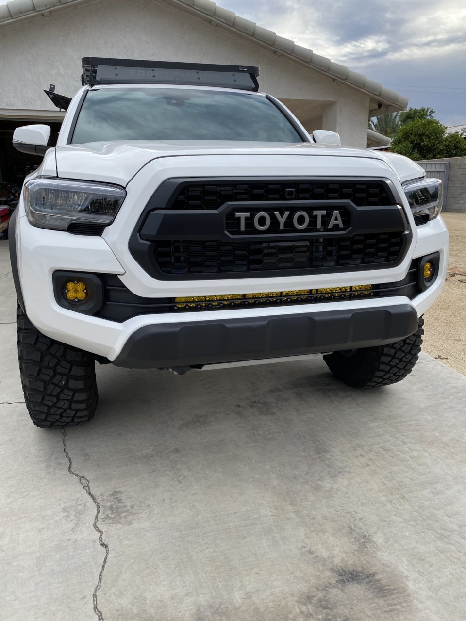

    I’ve gone through a couple options. Originally ran KC hid pro sports x4 on the prinsu. The hood glare was unbearable and the dust glare in the windshield was also a pain. Even minor dust from off-roading. Switched to a 40inch Baja designs s8 in dual color. I loved the slim profile but still had the same hood glare problem. At this point I noticed the yellow was a lot easier on the eyes at night. Then I switched over to the 30 inch onx6 behind the lower grille and it’s the best of all worlds, the output is amazing and no hood glare. Always behind the grille so no huge theft issue, no wind noise, no roof rack wiring running up there, all the light is infront if the vehicle where it’s needed. Also tuning two Baja designs LP9’s behind the 4Runner grille and love the mounting location.6A7CC999-FE36-4E13-8C57-A0E22B3355C7.jpgC190C4A5-C4AC-4DD7-8CC1-1BF4AF66F31E.jpg

    Thanks! My top 42" bar is white, and eventually when I get a bumper, that will also be white, enough yellow for me, lol....

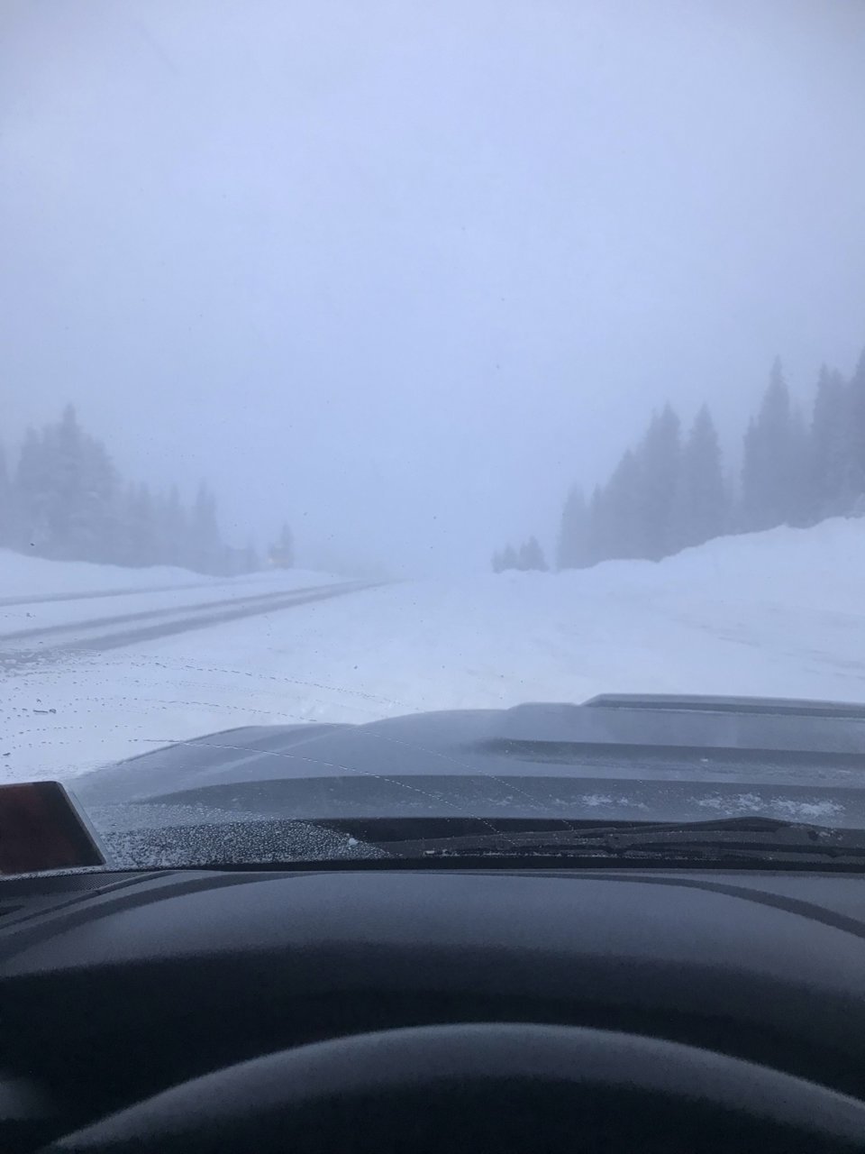

    I’ve got BD Amber fogs, they’re great for saturating snow and especially during whiteout/ low visibility conditions. They work pretty great, the picture doesn’t do them justice. They might be a bit overkill but it only takes one blizzard to make them worth the money.
