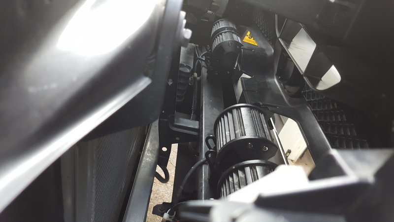

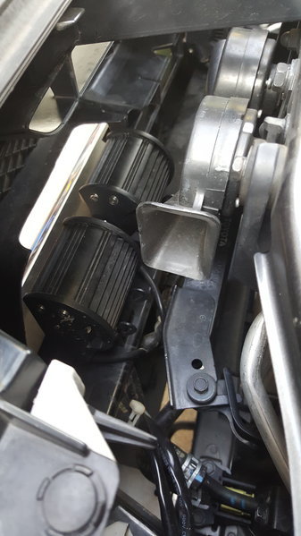

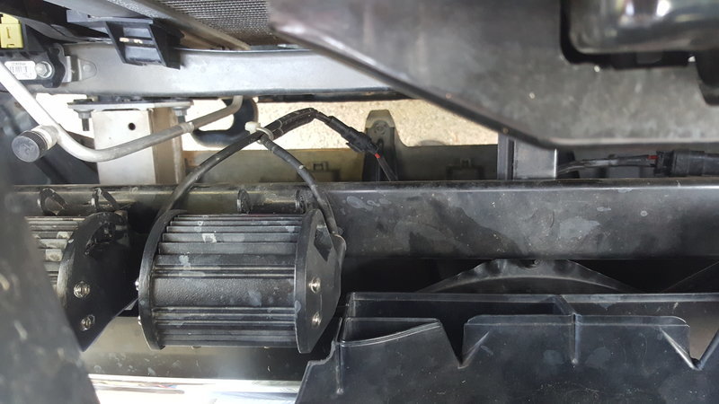

    4WTacoTRD Well-Known Member
    Mar 30, 2016
    #182864
    100
    Brian
    Marietta, Kennesaw- GA
    2014 Tacoma TRD

    What do you mean by open them up and seal them ? Seal them where exactly ?
    Great looking truck I knew that looked familiar in your pics that's ridgecrest use to pretty much live there and I have rode through that tunnel. Not sure where that snow pic is but it looks familiar as well .

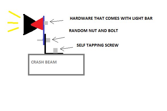

  15. Jun 23, 2016 at 7:14 PM
    #35
    EatSleepTacos
    Mar 24, 2015
    #151688
    59,835
    Randy
    West Valley, AZ
    2017 4Runner
    I used a 3' piece of angle iron (the kind with a bunch of holes) from home depot and screwed it into the crash beam with a single self tapping screw on each side. Super rigid. The blue in the diagram is just a strip of metal to elongate the angle iron.
  16. Jun 23, 2016 at 7:17 PM
    #36
    baboltin
    baboltin [OP] New to the 3rd gen world!
    Mar 18, 2016
    #181623
    1,139
    Brad
    Tehachapi,Ca
    2019 Toyota Tacoma
    Stock with a camper shell for now.
    Dang set me up right there thank you I think I got it now !!! I will post pics once I get it and mount it all up . Pretty excited .
