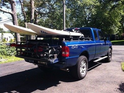

    U can also use a rack system. This is what I used on my ranger. I installed this on my Taco but do not have photos. Run rack tracks down the bed rails then build the rack. It's clean.
    I had to buy new cross bars for Tacoma since its wider but once I get it loaded up I'll post some pictures. This is a Thule system.
    Granted, the longest long boards I'm hauling are only 12 feet or so... Loading and unloading at chest height is something I really like about this set up.

    That looks great, but I need (wanted? ;) ) an over the cab rack in order to move an 18' canoe.
    I will say, I'm a tad concerned about the structural integrity of the lightweight rack, but it's primary function is to hold the canoe over the cab. The canoe will be securely tethered to the frame front and back, but wind at interstate speeds might overpower it.
