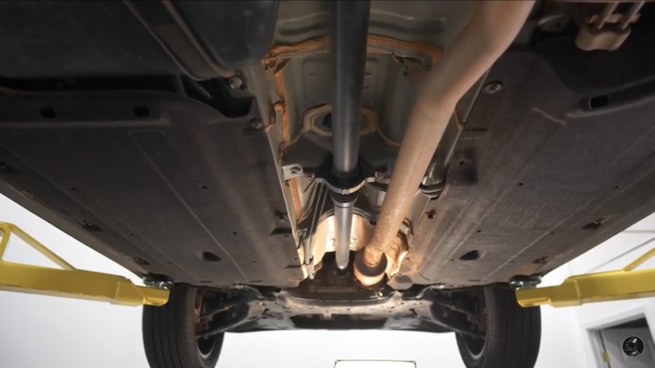

    I have the same concern. When you look at modern cars most of them have underbody panels to improve airflow and reduce noise, but they have a cutout so the exhaust is not covered. This may be beyond my fabrication skills.
    Spats is the industry name, which is also the term used for covering the wheel’s side like on the older Insight. I think they might sometimes also be a protective feature like you suggest, but when I see them on the Colorado I have to imagine they’re there for minor airflow improvements.
