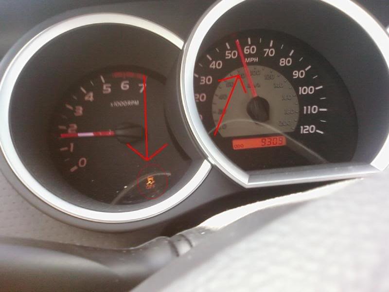

    Best I can do right now. Next week I'm headed out our hunting property, so I can get a video of it. Here is TRAC off while doing over 50. It stays off at 80+ on the highway or with the ass end slinging around in the dirt and the speedo at whatever. With the ALSD on and TRAC off, it comes back on around 30.

    doesn't VSC kick back in though?
    like over 30 VSC off lights up, but over 30 VSC is back on (so no "VSC off" light.

    No, TRAC and VSC are connected.
    This is quoted directly, word for word, from page 186 of my manual:
    Turning off TRAC and VSC
    "Push and hold the button for more than 3 seconds while the vehicle is stopped to turn off both TRAC and VSC."
    "If TRAC and VSC systems are turned off, the systems will not turn on, even when vehicle speed increases."
    "With AUTO LSD mode, VSC OFF and AUTO LSD indicator lights turn on. The TRAC system will turn on when the vehicle speed increases."
    Exactly the same thing I said.
    One thing I did not know, and it makes sense is that:
    "When the rear differential is locked:"
    "The active traction control system (ATRAC) is activated only when the vehicle speed is less than 3 mph."
