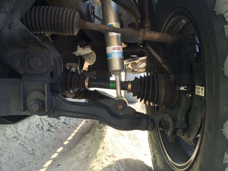

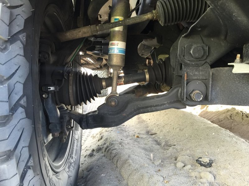

    My 4" RCD suspension with additional 1.6" Eibach lift. Pics of the CVs and LR UCA. You guys can continue hating on DB lifts but I've had both and I have no problem clearing my 34s and obstacles. Plus it rides better than stock:cheers:

    I'm not hating. To each their own. I was simply stating that the last time I heard of a lift like that (6" procomp with 3" in coil spacers) the trucks CV's literally screamed. It's not a knock on your setup, which probably places the front pumpkin at stock height.
    In my area it's not necessarily a good idea to wheel a DB lift, but I've seen it done. You just have to keep up on maintaining and checking it because it's one more point of failure added on to the truck.
