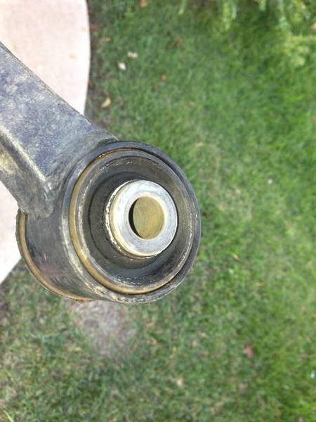

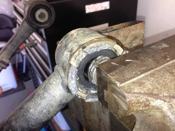

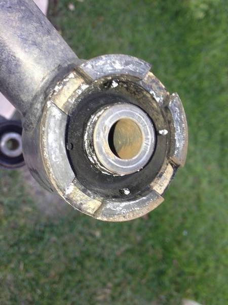

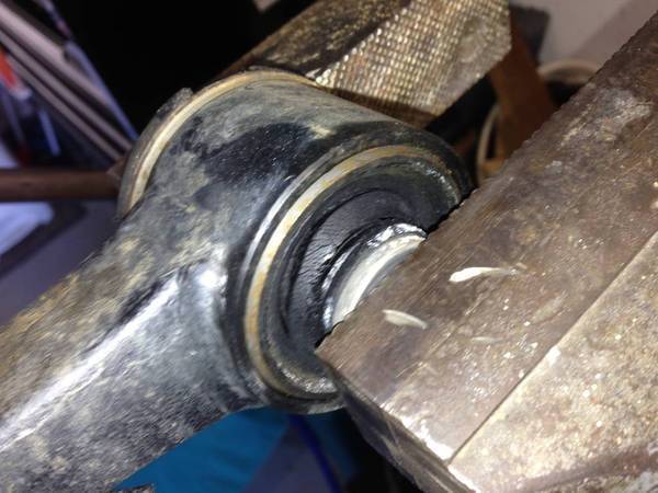

    I took a closer look at the bushings today.
    Looks like they do need to be replaced. The metal insert is still connected to the rubber. But when I flex the rubber I can see cracks. After some time the metal insert will start to become disconnected from the rubber completely.
    Your thoughts?
  15. Jul 13, 2013 at 6:06 PM
    brutalguyracing
    brutalguyracing BIG DADDY
    Jun 28, 2009
    #19000
    24,032
    F.U> GUYZ
    broken mods
    thats u squeak.......
    welcome to the world of pos uca's
