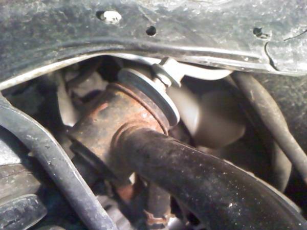

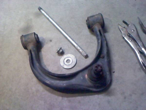

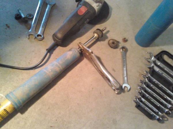

    I used the cheap B&D grinder, commonly found at Wally World for under 30 bux, with a $2 dulla cut off wheel... not the grinding disc it comes with... seen in this pic -
    Slid the UCA bolt toward the inner fender well and sliced it off as seen here -
    Which yields this in no time flat -
    Be sure to wear gloves and keep your eyes / face out of the way from the cutting disc. Take care not to lean the grinder while you cut... you don't want to bind the disc under power as it can shatter and be quite harmful to the operator. Safety glasses are worth the investment when using any power tool. You'll end up with a nice install, just as Viking outlined above.
