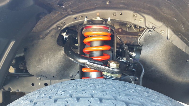

    I just installed LR ucas. Here's my report:
    1. Find a shop with experience installing LR's. (first shop couldn't solve the riddle; second shop knew LR's like an old friend);
    2. On pavement/around town: Excellent;
    3. On pavement/highway (405 & 110 freeways): Excellent;
    4. I had a bad driveline vibration prior to my lift---but no vibe post-lift (crazy, right?);
    5. With the $$ I saved buying the LR's ucas (vs. TC or Icon), I bought OME 887 springs (had them powdercoated red), and 3/4" plates from Toytec.
    So far, so good---looking forward to testing it out on some sissy trails....
