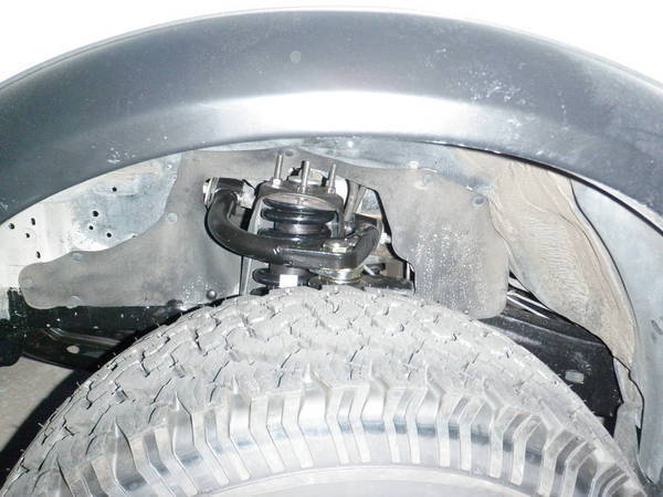

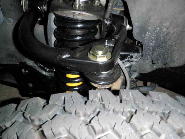

    Just got my truck back... OME Lift with Light Racing Upper Control Arms.
    Drives like a dream!
    My buddy who is a mechanic installed everything. Ride is great. He was impressed with the UCAs. He said they were designed really well - very easy to adjust and align the vehicle - They are a must have for perfect alignment!

    Congrats on your new lift. Don't love it when a plan comes together.:woot: Got an pics you can post? I am considering the LR UCAs myself.:D

  12. Jun 22, 2010 at 8:12 PM
    toycar18
    toycar18 Well-Known Member
    Apr 24, 2010
    #35896
    223
    Colorado
    98 Reg Cab 2.7L
    OME Suspension, BFG 33x10.50 AT, Light Racing Upper Control Arms, Rear ARB Air Locker, LCE Header, Dynomax Super Turbo Muffler, K&N Intake
    My truck drives perfect with the new OME suspension and LR UCAs.
    LOVE IT!
    I would highly recommend OME suspension with LR UCAs, 33x10.50s, 4.56 and arb air locker!
    You can't go wrong!
    Steering Rack Bushings are also a must!
