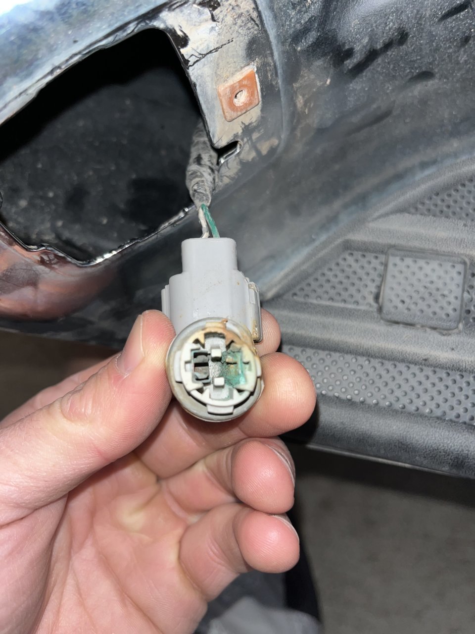

    Anyone know where to get this license plate light socket?
    Mine is shot

    It appears to be 81275-04010. But if the plastic has not melted, just clean out the corrosion and apply some dielectric grease to the metal contacts.
