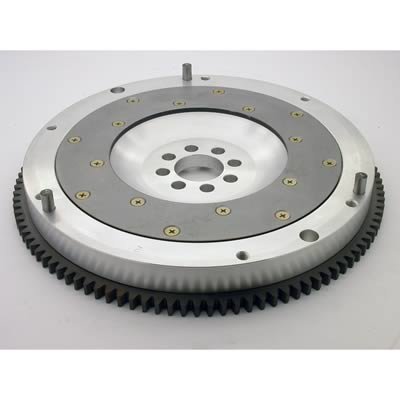

    Here is a pic of the Fidanza 7 pound flywheel. $399. from Summit RacingFidanza 7 pound wheel.jpg
    Any recommendations for a good clutch, particularly a light weight/aluminum unit???

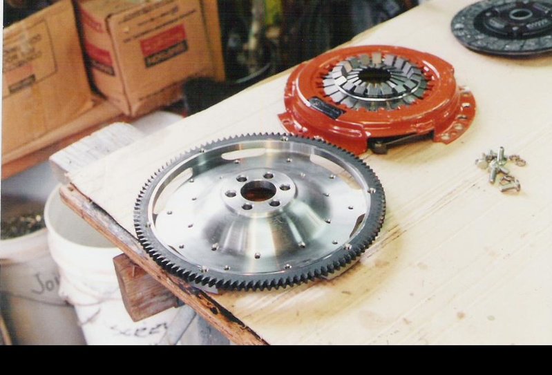

    Here is a shot of my 85 Toyota xtracab engine ready to go into my work truck. This was a 12 pound steel billet from LC engineering. I just got rid of the truck, with 424,000 miles. The light wheel really helped perk up the engine. When I got into my "new" 2001 Coma, I was slightly underwhelmed with its slow revving, but that is fixable. If I could find a light pressure plate, that would help also.

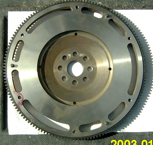

    The second photo shows the flywheel from my old Ferrari. It went from 16 pounds down to 8. The pressure plate is about the same and it is a 3 liter 8 cylinder, so the difference isn't that great.

    All of these light flywheeled cars and trucks were a bit touchy leaving the line, (even in mild street driving), particularly, the 4 cylinder ones.
    You are correct that lighter internal engine parts, (as well as lighter wheels, axles, tires and drive line components), don't increase the horsepower numbers at all. Measuring output on a dyno would yield exactly the same numbers, with either wheel.
    BUT, lighter components will spin up faster, because less of the engines output has to be used to accelerate the mass, it is available sooner to accelerate the car or truck. It is kind of like two equally strong guys in a foot race, one wearing tennis shoes or track shoes and the other guy wearing heavy insulated work boots. Guess who gets to the finish line first.
