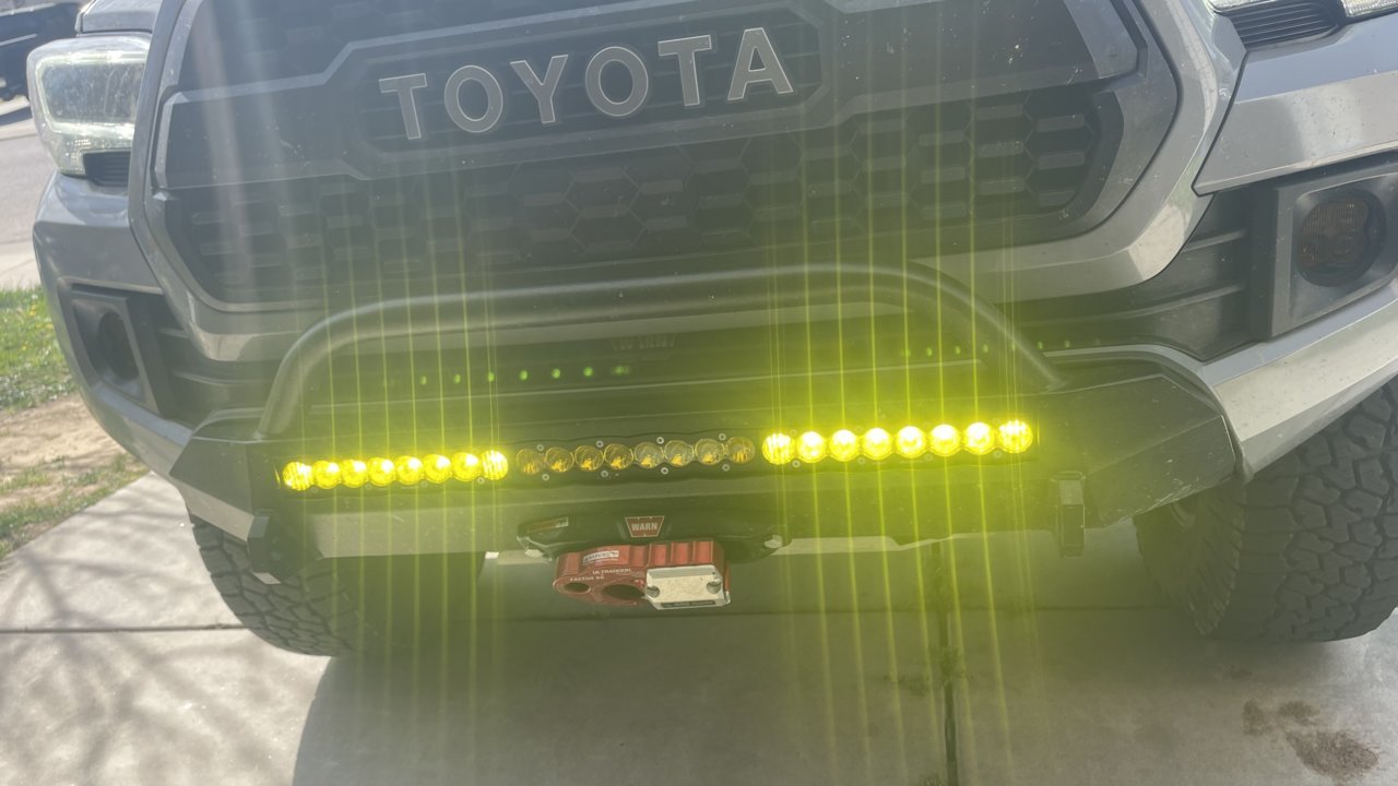

    Would this be a jumper issue, how hard would it be to fix it? Don't really want to take off the bumper. Had the light installed for about 6 months. Was working fine til I realize my middle section backlight wasn't working. Checked and both backlights and main lights doesn't work.

    2017 OR DCLB
    ICON8 Lift -285s. upTOPoverland rack.
    Loose wire or ground.
    Check all you connections.
    If you have good voltage at the tail end, there’s a loose wire inside the unit. If it’s under warranty send it back. If not, open it up and check everything. Likely something is shorting to ground and draining voltage between the working and none working banks. Easy fix once you locate it.
