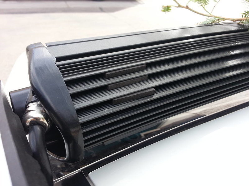

    I had mine mounted exactly where yours is with the cali raised brackets and it hummed so bad that my roof vibrated and could not even talk in the cab. To reduce noise i installed 1/4” tubing between each heatsink and filled every other fin with black silicone. This reduced the noise about 50% this will pretty much make the lightbar un resaleable. I then installed black duct tape along the bottom & top front edge of the bar covering the little screw heads. This reduced noise again.
    In the long run i indeffinetly removed the lightbar gave a bodyshop my left nut to weld in the holes and paint then fabricated some brackets to mount it onto my prinsu. Still with the 1/4” tubing and the black silicone. No noise unless theres a perfect crosswind. And even then its barely noticeable. Hope this helps op.

    I ended up having to use a medium-high density foam trimmed slim enough to stuff in between the fins on the back.

    ImMrYo Rear view mirror lift bracket. Changed out mud flaps. Salex glove box organizer. OEM Ashtray (cup). AVS Step Shields. 16x8 SCS F5 Matte Jet Black. 265/75 16 Cooper St Maxx. OME Bp-51s. U.S. Offroad Winch Mount (in process) Smittybuilt x20 12k synthetic winch (in process) More....
    Just at the ends? That shouldn't affect the cooling and sounds like a great solution.

    I did 3 rows.. spaced evenly.. with about 3 pieces each. Let me see if I can find anything when I did it .
    Edit: found an old picture..
