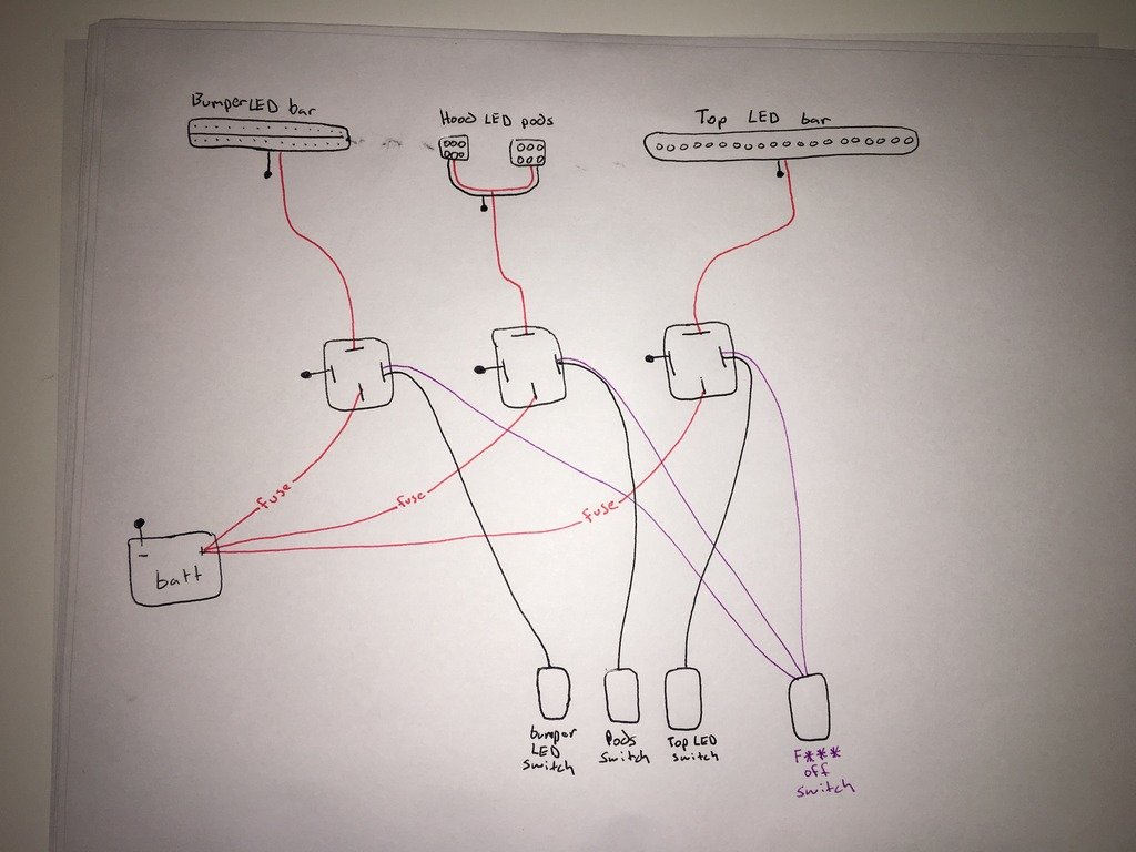

    Okay so i have an idea and not completely sure if you can do this. I found this switch from OTRATTW that I think would be humorous to have, and I tend to high beam people when they do stupid things like cut me off, so I might get occasional use out of this.
    But I was wondering if you could still control a bumper light bar, pods, and top lightbar separately but also wire them to the f*** off switch to quickly turn them all on and off. I made a diagram, to help explain what I'm trying to do.
    So yeah, just curious if this would be alright and work the way I am imaging :D

    The way you have it drawn, no. If all 3 go to the same post on one switch, when you turn on one, it will back feed to the others also.
    Run the control + from one switch to all 3 relays. Run the control - from each relay to their individual switches.
    I am by no means telling you to do it. Your reasoning behind it is illegal and dangerous. However, in a technical post, that is what I'd suggest. I have similar setup. But my control + is activated by my high beam circuit while the control - is on a switch.
