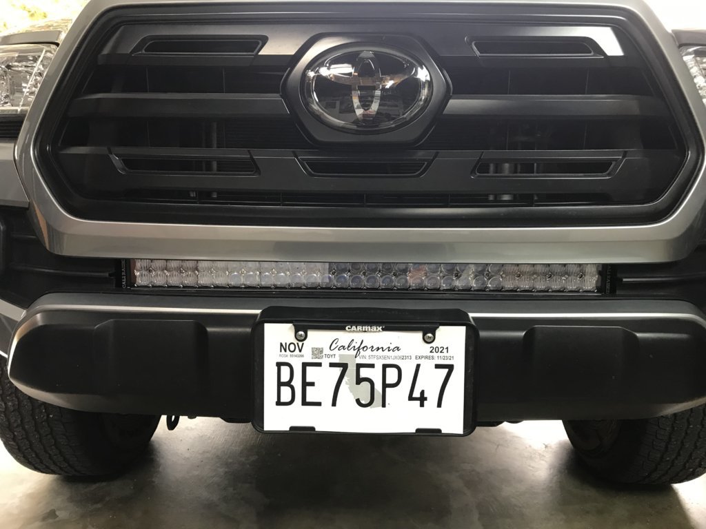

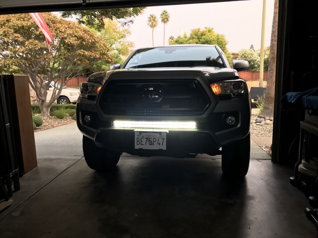

    I went with a Cali Raised LED bar..came with everything needed including brackets. Great quality, I’m very happy with it so far..
