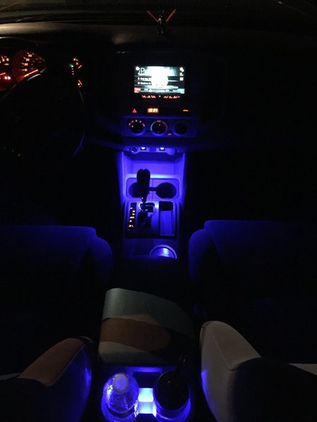

    I can get a pic tonight. I added a a distro block via add a fuse to switched ignition then used a few 5mm led's in the footwells and 1 up into the base of the cup holder with notches for the light to come out, just used some clear tubing to diffuse the beam pattern.
    Bus bar
    https://www.amazon.com/Blue-Sea-Sys...rd_wg=e0jgZ&psc=1&refRID=EPREG2H0DQJE3HRB4RVQ
    Leds (pre wired)
    https://www.amazon.com/120PCS-Color...8&qid=1491925430&sr=8-1&keywords=prewired+led
    These are powerful enough to add good accent lighting, not extremely bright vs some.

    Can kind of see here

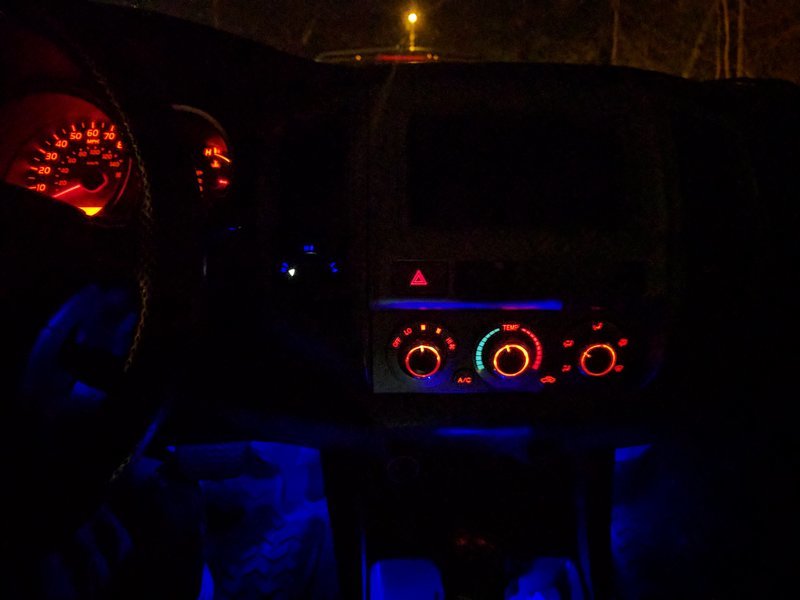

    Finished mine this weekend. All 3mm LED's wired to the supply from the climate controls.

    Got em from Ozmium.com The 3mm Superbright ones. I sanded down the from curve off on all of them to give them a more flood rather than a spot. There are two mounted underneath the climate controls shinning down using the 3mm LED holders from their site as well. There is one in each cup holder drilled into the side and glued from the back with epoxy. Sits nice and flush to the inside. Shipping was nice a fast too, ordered them and 3 days later there they were.
