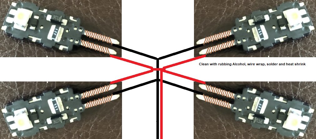

    Got my console lights today. Now I need to figure out how to make them work in the cup holders.i know I will be drilling holes to mount them, what I need help in is the wiring. I know it was mentioned that the Koito pigtails would fit but they are pricey. I will need at least 4. I’m wondering if anyone who is good with electrical wiring would have any suggestions for another type of connectors.
  6. Dec 9, 2019 at 12:10 PM

    I take it you didn't read the link...

    I read the link, but I was hoping for a connector already setup with wires. If I understand the link, I would buy the connector, then the pins and wire and put everything together. If I’m wrong let me know. Thanks, I appreciate your help. You seem to be an expert on wiring, wish you lived next door. I will be down your way around the end of January.

    Yes, that be it.:thumbsup:

    upload_2019-12-9_16-59-35.jpgVerify polarity before you solder...

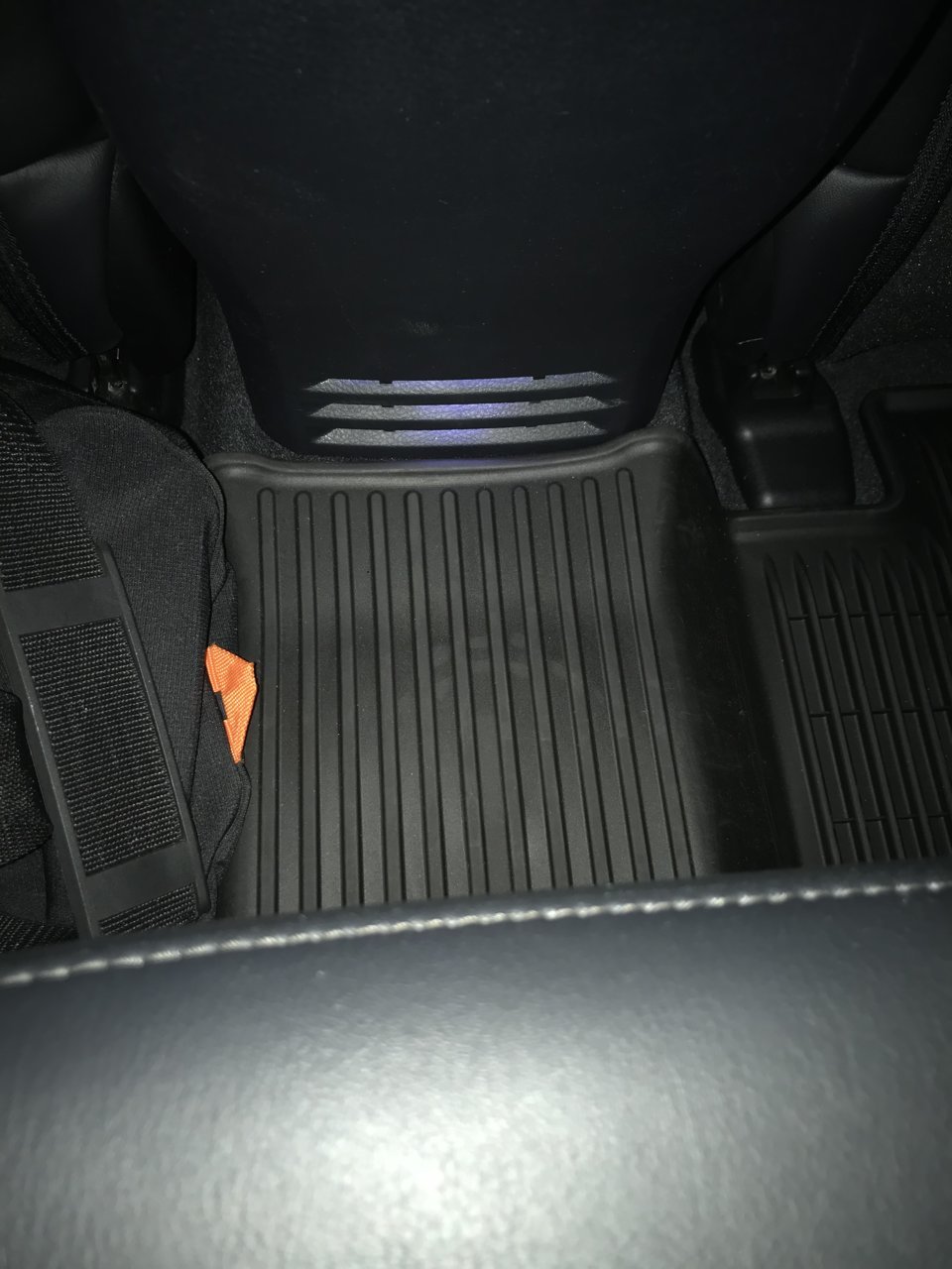

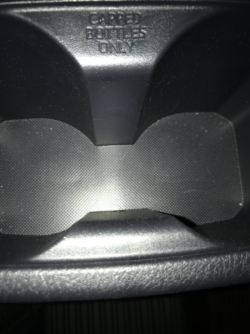

    Finally got my cupholder lights installed. I went with 81080-12100. I installed one in each cupholder in the center console and one in the rear cupholder. I ordered the connectors from Retofit that was recommended. They worked out perfect for me. While I had everything apart I wired in a set of lights in the rear console vents. The rear lights serve no purpose, just adds a nice accent touch. The cupholder lights seem brighter than the light for the wireless charger. Don't know why. I tested the lights with and without the diffuser and there seemed to be no difference in brightness. That does not seem to make sense, but I could see no difference. I travel a lot so I'm driving late at night or early morning, so the cupholder lights eliminates my fumbling around to place my coffee cup.

    My bad. Here are a couple pictures.
    First picture is the light from the rear vent, second picture is the rear cupholder.
    The pictures of the front cupholders in the console did not come out too good. I need to take a few more of them tonight when it is dark.
