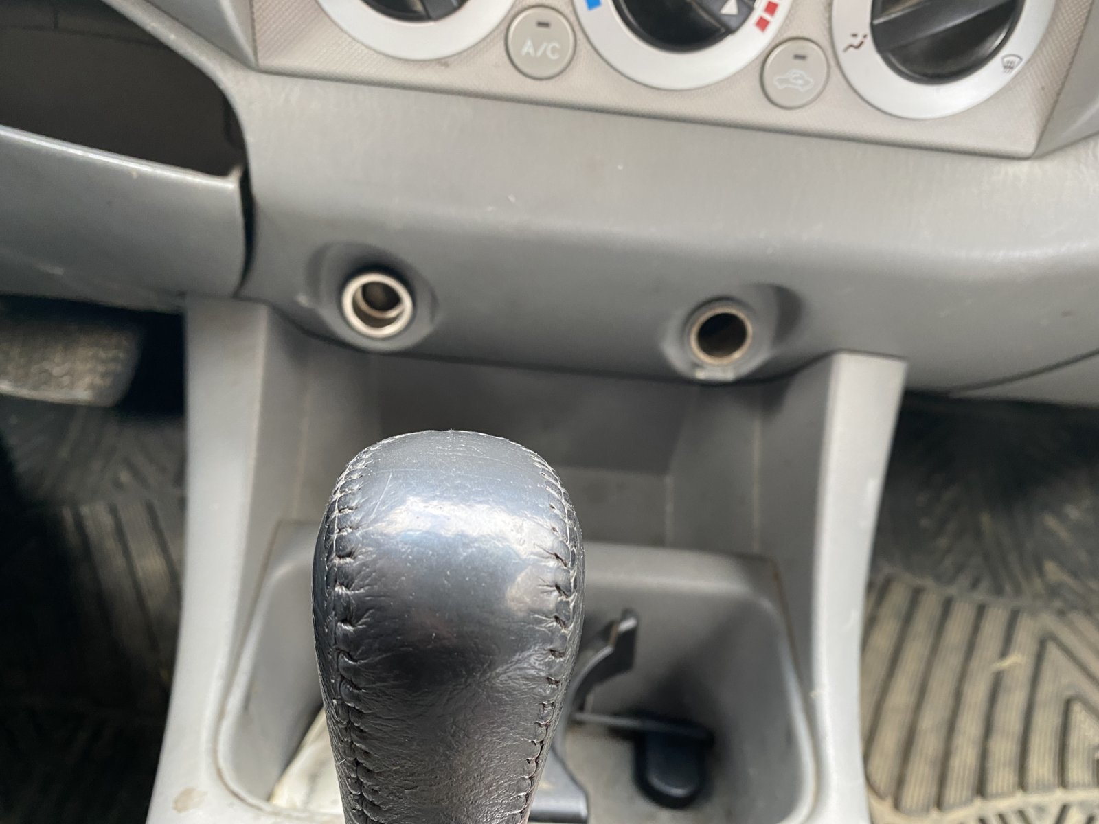

    How do i remove the destroyed outlet on the left?

    It's not hard but you might consider it a pain in the ass. You need to remove the the panel and get to it from the back side. I think you may need to remove the center console and glove box. There a bunch of videos showing different stages of the dash removal but not one good one that goes thru everything thoroughly. I just watched a few by the end I had a pretty good idea. Not hard at all just clips and 10mm's. It's a good time to do a deep cleaning under there too.

    It is a nightmare for me.
    You have to remove most of the front fascia of the dash. To do it “properly”
    But I didn’t want to do that. So I ended up reaching around from underneath by removing the center console, scratched up my hand pretty badly trying to remove the push pin.
