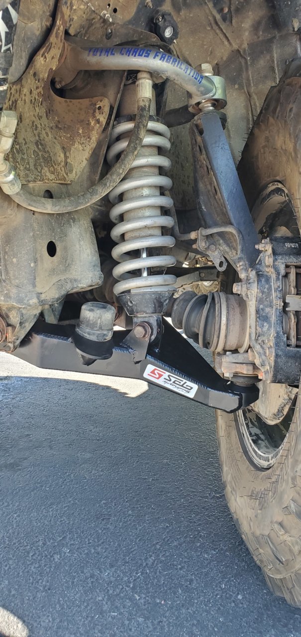

    Is the full weight of your truck on the ground in this pic? Your CV axle angle is much greater than mine.

    Yea that's full weight on the ground.
    I shoot for about 18.75 length between the top of the top hat to the lower eyelet.
    About 1.30 in shy of full extension for these shocks iirc.
    I will add limit straps eventually. And I'm not really concerned with CV angles since I have manual hubs so they're only ever spinning on the trail.

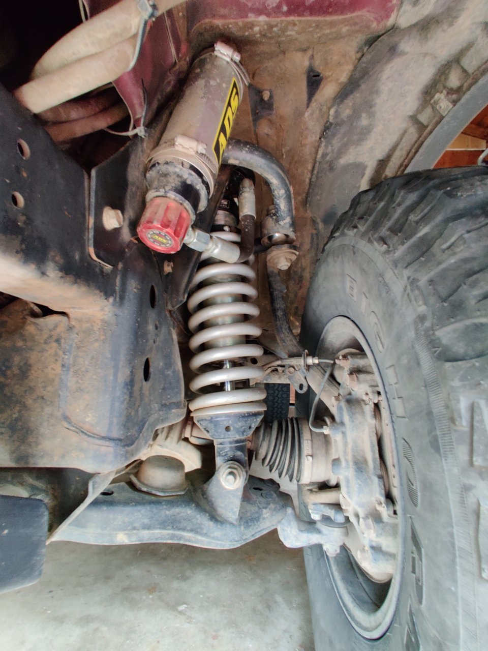

    I suspect you will sit lower than you like if you swap to Dan's COs.

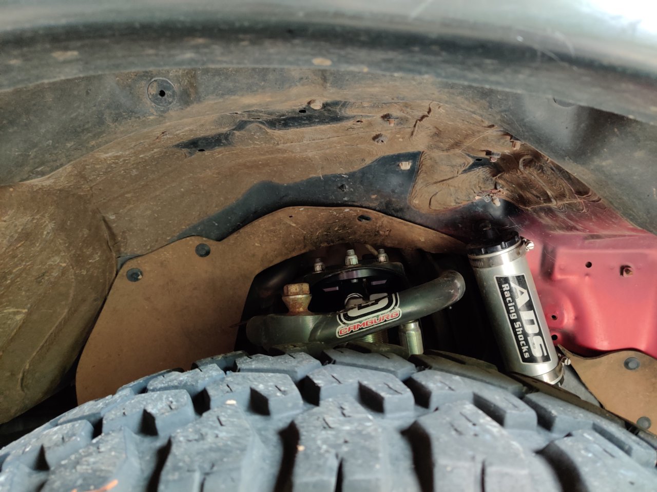

    Here's what my passenger side looks like:
    Same side, what the UCA angle looks like:
    That's 23" from center hub to the bottom of the flare.

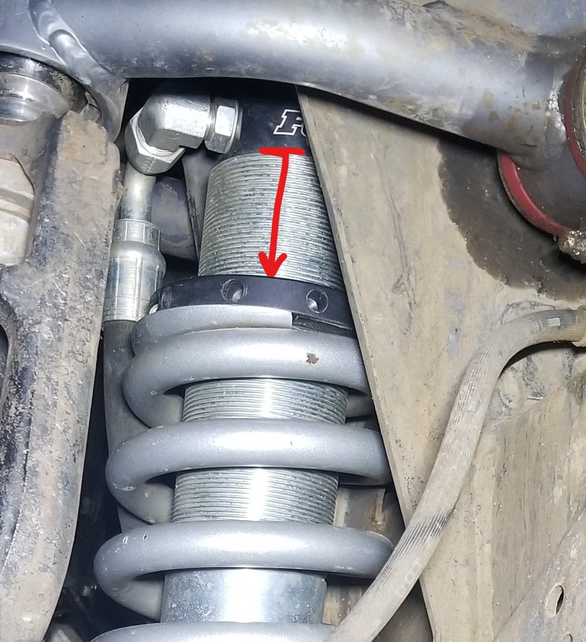

    I'm measuring from the top of the threads where they start to the top of the upper spring perch.
    (note this is an old picture and not representative of the preload I currently have)
    You might be right. I also just might be shooting for too high of a ride height.
    I'll take a measurement of the fender to hub when I get home to compare
    EDIT: I'm 22.5-22.75" from hub center to bottom of flare. So same amount of lift as you I guess

    Threads showing is not preload, its just threads showing. If you are going to start comparing your setup to someone else's and do it accurately, you would need to scale both vehicles to get corner weights, then gather shock lengths for each coilover to compare. Shock bodies could be different lengths etc. You are not comparing apples to apples. We reference numbers like this on the daily btw Fox/King coilovers. They are not identical
    To measure preload on an OEM coilover, you will need to measure the spring when the shock is fully extended. Subtract that number from spring length (14").
    Maximum preload= (spring travel) – (shock travel),
    Min Preload = (spring free length) – (coilover spring space)
    This article may also help with understanding preload and shock setup:
    https://accutuneoffroad.com/preload-adjustments-on-oem-fit-coilovers/
    https://accutuneoffroad.com/oem-front-coilover-shock-setup/
