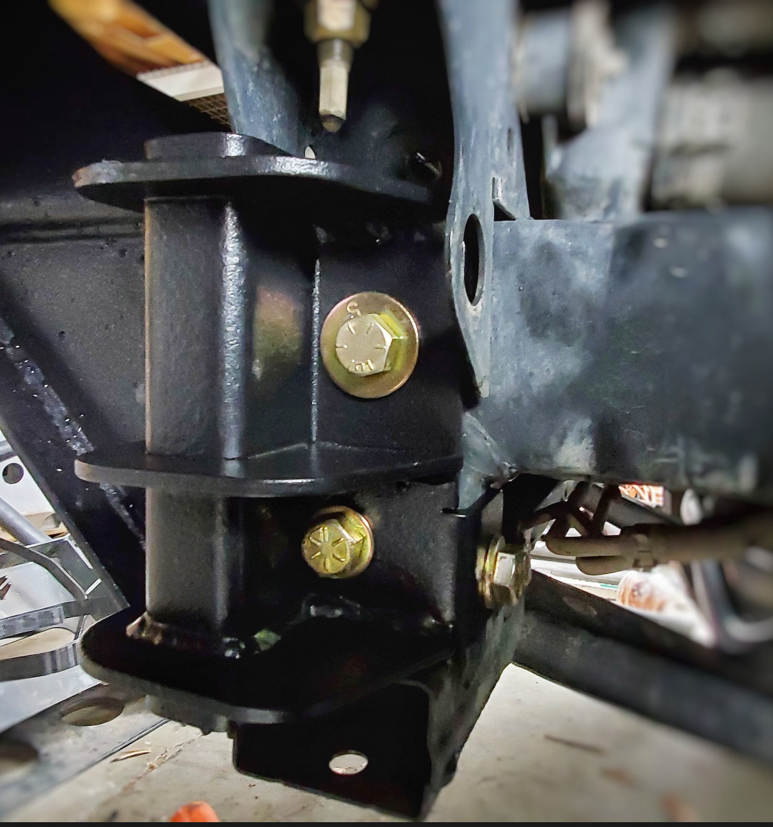

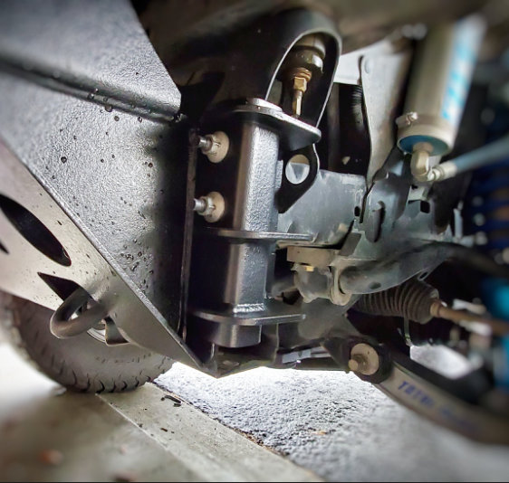

    The receiver bumper mounts exactly where the victory or any other aftermarket bumper mounts to the frame, it's definitely a stout piece of hardware, gusseted above and below. upload_2023-10-5_1-11-22.jpgAnd then reinforced with the reinforcement brackets that add 3 more grade 8 bolts to the mix. upload_2023-10-5_1-14-49.jpgupload_2023-10-5_1-14-49.jpgAbout the frame, there’s not much most of us are going to do about that, now is there.

    Your over looking one component regardless of how the piece is built raising the location the force is applied above the mounts to the frame that leverage amplifies the force the mounts see. The majority try to mount the winch plate as close to the mounts for better force distribution. That's why I'm saying it's a good thing you have the reinforcement brackets

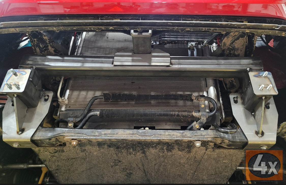

    ^^^CaptainBart45 does that bumper tie into the bottom of the crossmember? Did you/are you going to install a bumper reinforcement bracket to tie it more into the frame?

    Not to the cross member, however it does come with reenforcement brackets that connect it to the frame. At 17:30 you can see the brackets.https://youtu.be/kOuiJQipbGw?si=TZS-QguI6OvhY6Zq
