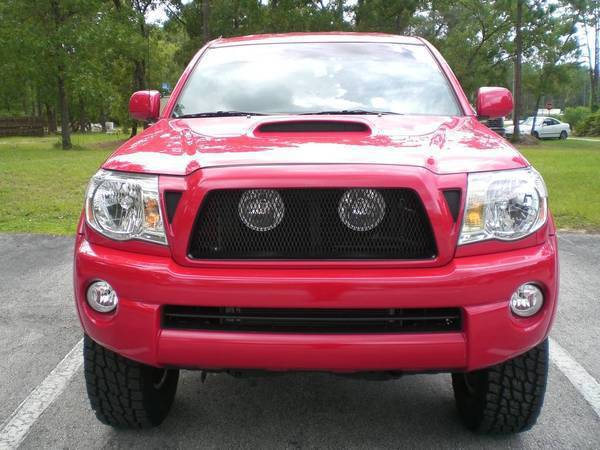

    I am not sure if there is a post on this yet.. I am going to add a custom grill to my taco and want to put two lights inside the grill and not a light bar. Kinda there but not there.. Does any one know of any kits for this?

    Like this?

    Yes..Yes..Yes!! love that look it is so nice and clean.. Do tell your dirty little secrete.. on how you did it and where you got you stuff..

    It depends on if you do it with a Grillcraft and flush with the grille surround, or if it's deep-set like mine. The only way I have seen it done with a deep set one is using the top support of the radiator (I believe it's the radiator), using some pre-drilled holes or drilling your own.
    The flush version with the Grillcraft I believe requires you to mount them to the bottom of the grille surround with aluminum. If any of this is incorrect, someone please correct me :D Good luck!

    Thank you so much. Love the way it looks on your truck..

    Here's a picute of what mine looks like installed. The lights are Hella 500 Black Magic.
    Buy yourself one of these light brackets:
    http://www.tacomaworld.com/forum/gr...lements-light-bar-behind-grill-group-buy.html
    They are not cheap, and I hesitated to buy one at first, but after installing it I can tell you it's worth twice the money. Solid, well thought out engineering and when the lights are installed they are solid as a rock.
