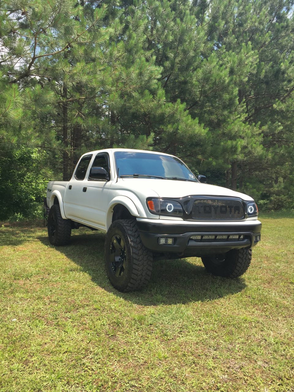

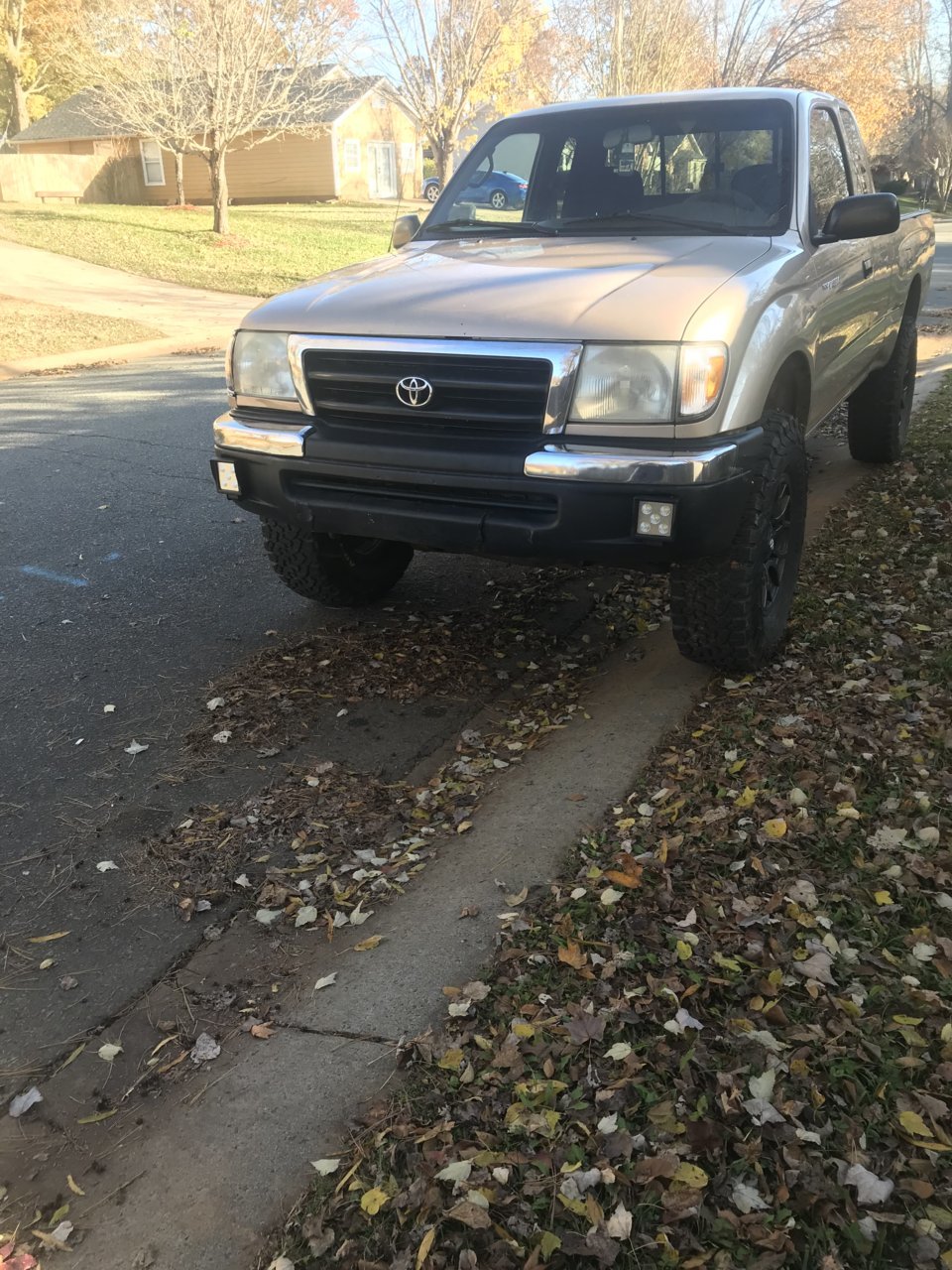

    2004 PreRunner
    3" Lift kit, Bilstein 5100 front and rear, 2881 EMU coils, 2" Deavers AAL, 18x9 KMC rockstar 1 wheels and 33" Nitto Terra Grapplers, Debadged, Grillcraft insert, clear corner and turn lights, 6k Leds, 30" Led light bar, 4 Pod fog lights.
    Corner Led lights are Turn signals along with switchback halos. Fogs are 3" pods ran on a switch.

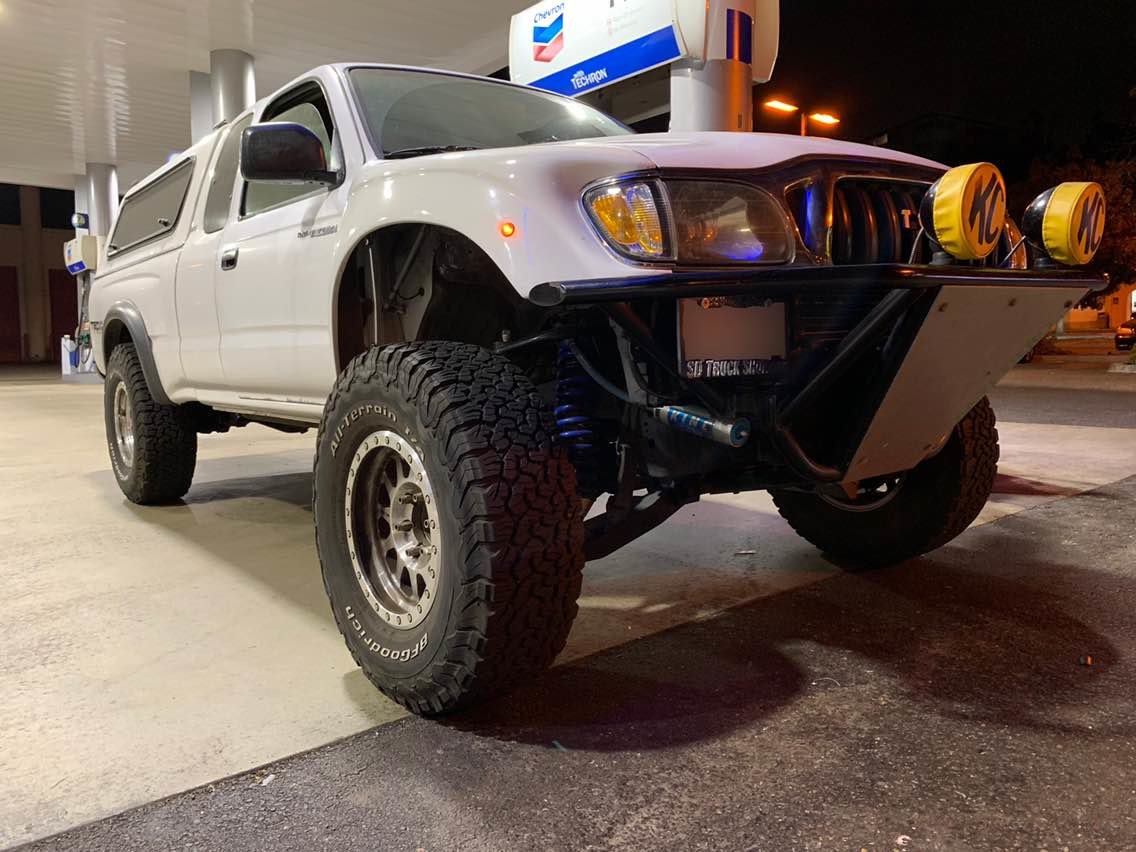

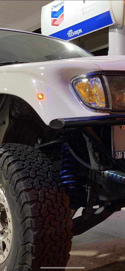

    2002 Tacoma SR5 TRD 3.4L V6 4X4 Ext.Cab
    ARB Bumper Westin 9500LBS Winch PIAA Lights X6 OME 2" Lift OME Heavy Duty Leaf Springs MBRP Exhaust K&N Air Filter Toyo R/T 285/70/17R

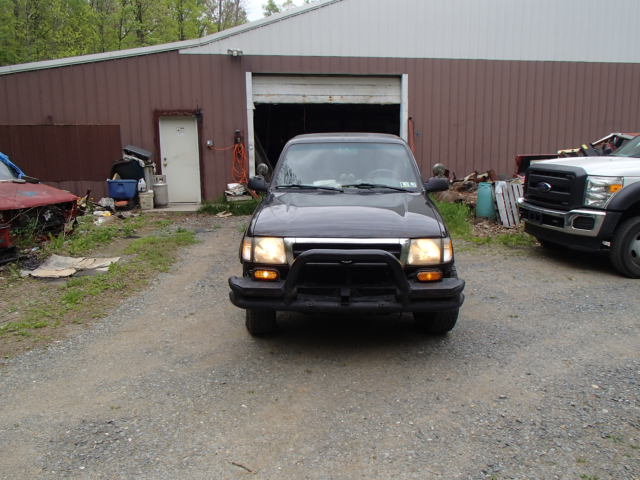

    pics of rear bracket?

    It's just an L bracket bolted to the frame for the pods.

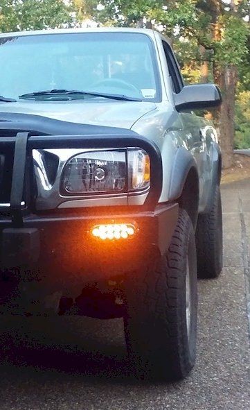

    Pods in the bumper
    Or just light bar town
