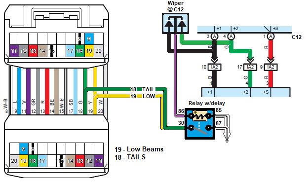

    Has anyone come up with a way to have the headlights come on when you turn the wipers on? Both states that I drive in have a lights on when wipers are on law. I wish they would come on when you have the headlight switch in auto.

    @caribe makaira and I discussed this quite a bit sometime ago. It’s possible, but I couldn’t find one of the connectors to make a tee for it. If someone wanted to use some taps, I could still build something. I’m not sure where and what wires to tap, but I’m sure Caribe could remind me

    Haters gonna hate...:redxfall:

    What are those two wires at C12? Low and high speed wiper?
