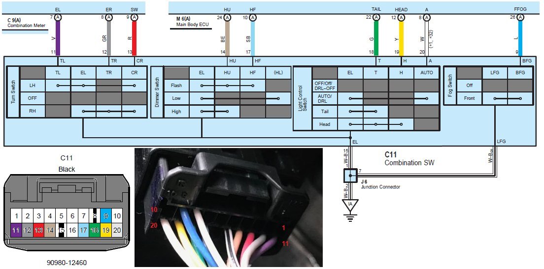

    Yes

    Nice. The only refinement I would make is on the stalk switch, I would just tap 19 (low beam). When it is grounded, 18 is as well, so no need for both.

    That is incorrect. We are bypassing the stalk switch, so they both need to be tapped.

    When 19 is grounded, it turns the parking lights on. At least on my truck that is the way it acts. It's in the diagram as well.

    Again, through the light stalk. We are bypassing it.
