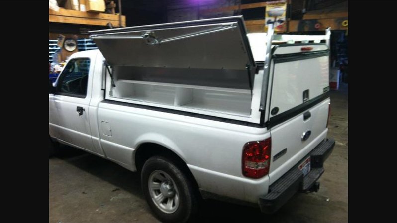

  4. Dec 19, 2016 at 10:41 AM
    WarrenG
    WarrenG [OP] Well-Known Member
    Jan 31, 2015
    #147585
    575

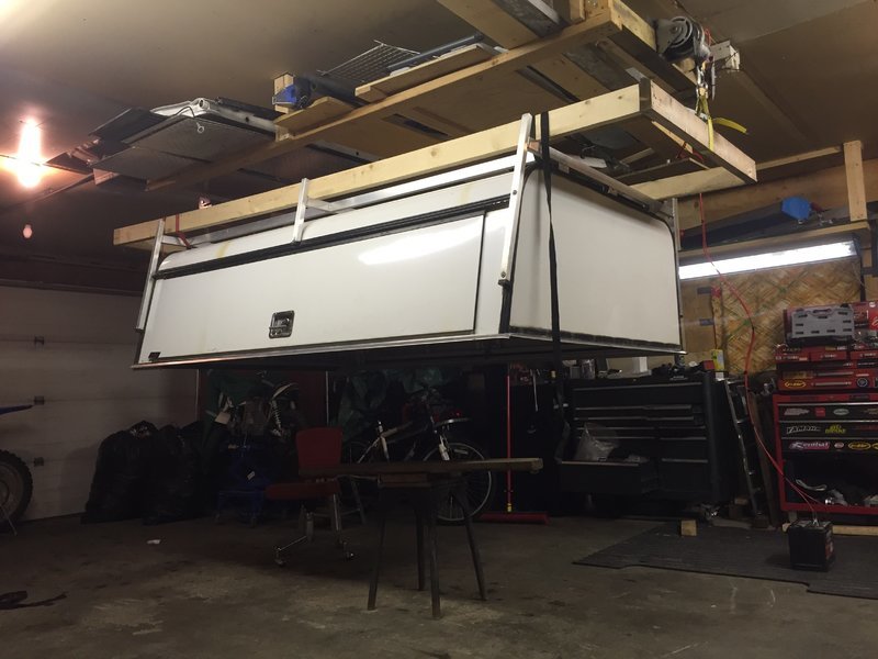

    I started with 2 aluminum toppers. Original plan was just one but buddy threw in the other for $20 to get it out of his life! Total cost, $240.
    They are roughly 5' x 7' by 36" tall.
    He said they were from a ford ranger. Here is An example of one. (Not mine)
    One was in decent shape, one was missing side doors and kinda beat hence the $20 price tag. Both had roof racks which gave me extra material for the build.

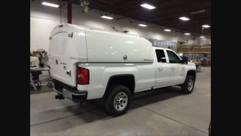

  5. Dec 19, 2016 at 10:52 AM
    WarrenG
    Jan 31, 2015
    #147585
    575

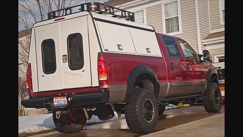

    I wanted something that was a mix of all of these, but keeping it a 1 piece unit was very appealing to me (like the space kap)
    ChadsPride likes this.

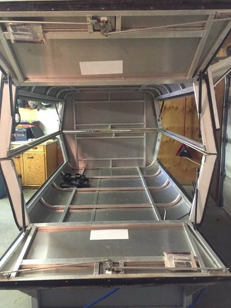

  7. Dec 19, 2016 at 12:56 PM
    WarrenG
    Jan 31, 2015
    #147585
    575

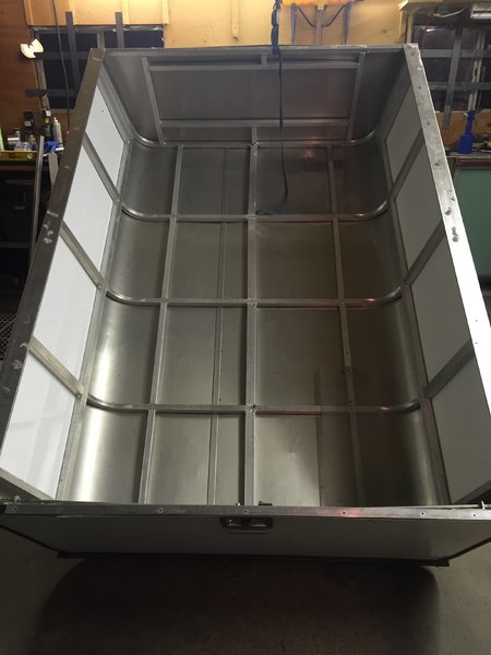

    One of the toppers was missing the side doors, so they had to be filled in. Im a sheet metal journeyman and apprentice welder so metal was the first thought, but went a different route. 1 sheet of puck board, some aluminum and some screws did the trick.
    Its really neat material, food grade and almost indestructable. Cut with a circ saw.
    Chipskip and medic2230 like this.
  8. Dec 19, 2016 at 12:58 PM
    WarrenG
    Jan 31, 2015
    #147585
    575

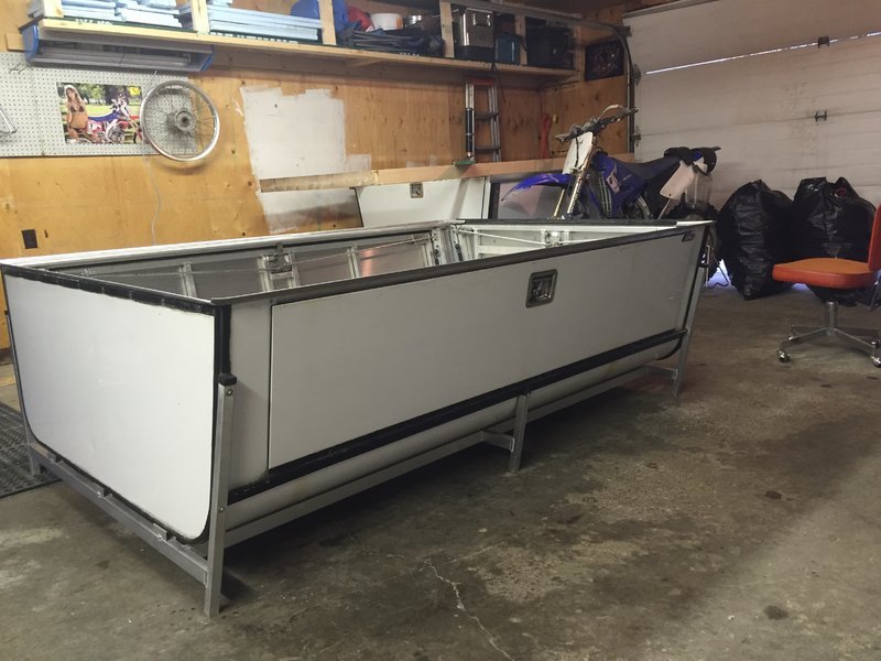

    Cut up the one of the roof racks and welded in supports for the missing doors and for the floor. I guess the bottom half weighs 70 lb at the most.
    medic2230 likes this.

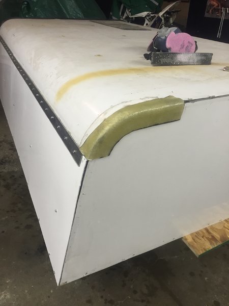

    The bottom piece was a little beat and missing some of the seals so had to get creative. I want it to be quite waterproof without relying on piles of caulking. Straight seams are easy with aluminum angle but curves are tricky. My buddy offered up his fiberglass skills so we made these bulletproof pieces.

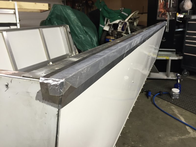

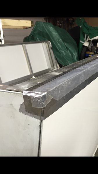

    575

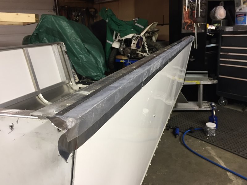

    I tried to silicone the puckboard to the aluminum to make it weather tight. Doesnt work, puckboard is wierd stuff.
    Used 1 layer of 3m tin tape (quebec chrome) and 1 layer of industrial clear tape (not sure what its called, but we call it sex tape for some reason). Both tapes are unusually thick.

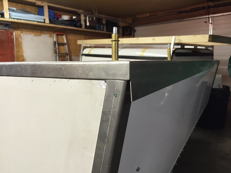

  12. Dec 19, 2016 at 7:00 PM
    WarrenG
    Jan 31, 2015
    #147585
    575

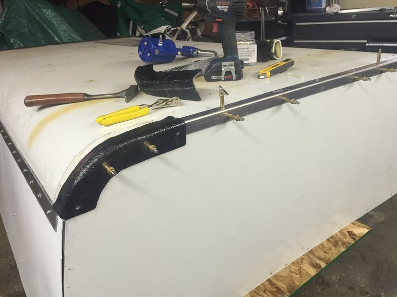

    Next came the drip edge over top of the tape. Top half will get something similar. Like I said, im not going to caulk the hell out of this and hope for the best.

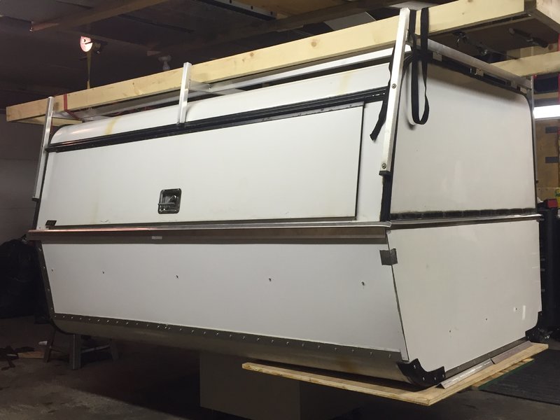

  16. Jan 29, 2017 at 8:05 AM
    #16
    WarrenG
    Jan 31, 2015
    #147585
    575

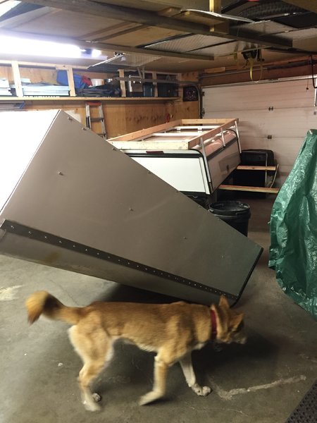

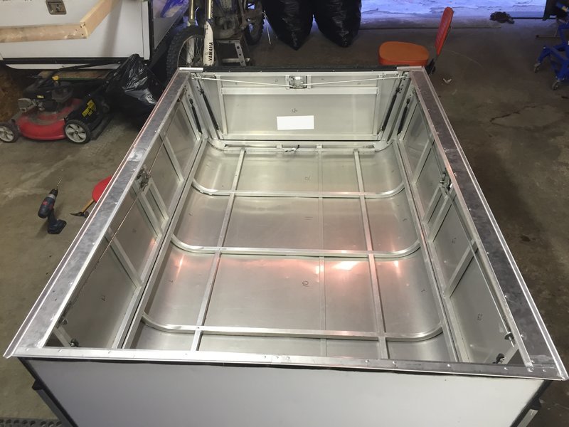

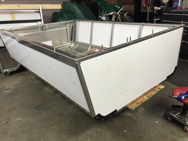

    We are having a chinook here in Calgary so took advantage of the warm weather to dig out the top half and get some work done. Top one has all the doors, a roof rack and was in pretty good shape after scraping and scrubbing the dirt off.
    davidstacoma, Manfred and medic2230 like this.

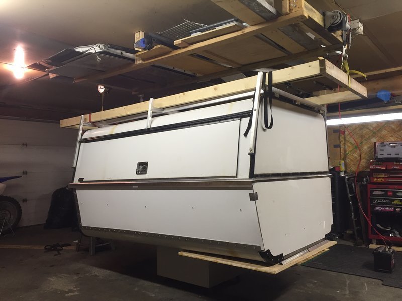

  17. Jan 29, 2017 at 8:10 AM
    #17
    WarrenG
    Jan 31, 2015
    #147585

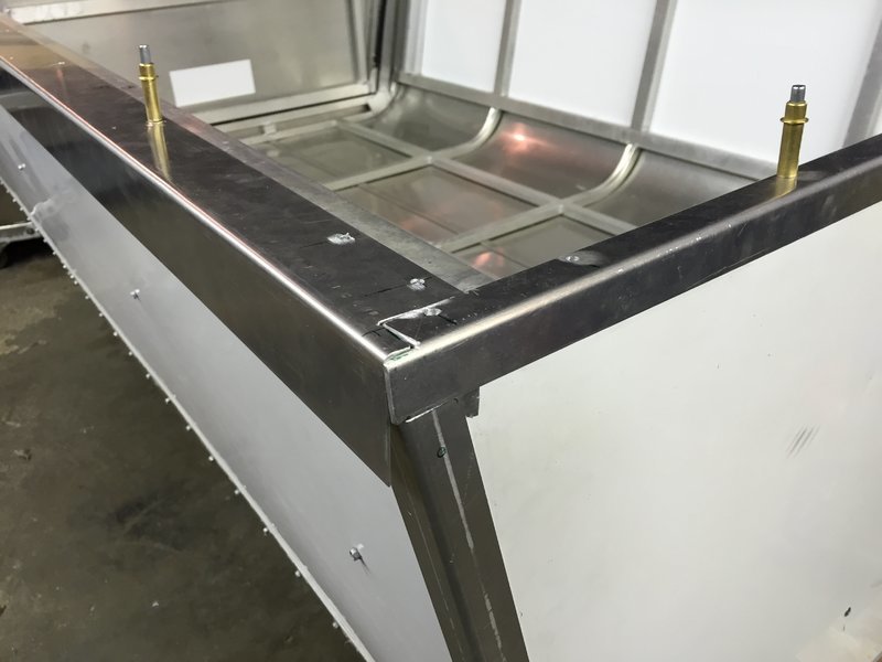

    575

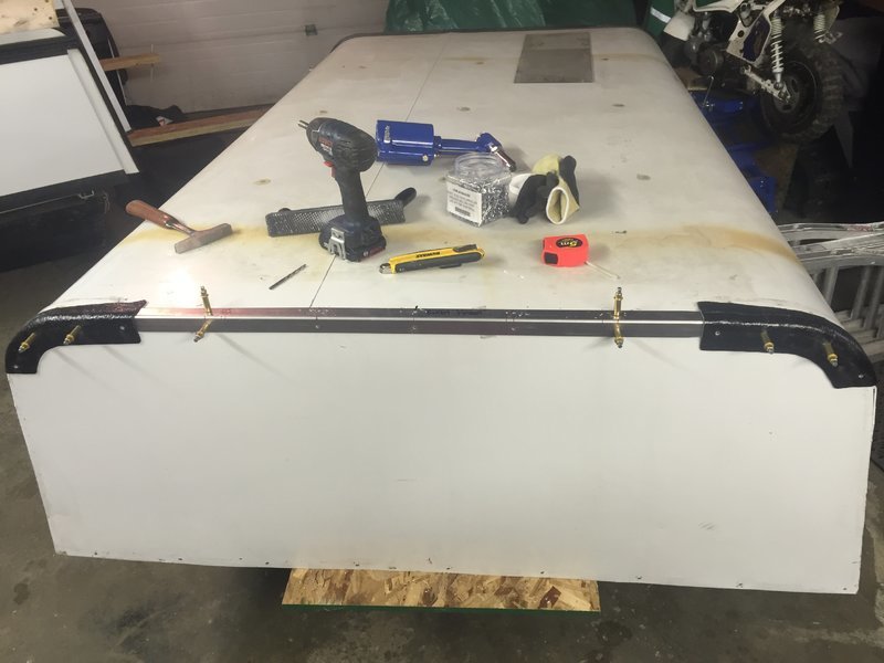

    Got all the top half drip edge fit up and rivited down
    All the insulation for top has been cut for a while, but will wait until the end to install. I believe there is 49 pcs. The radius on the top required many small pieces is make the curve. I found all this insulation in the attic if my garage when I bought it. Washed it up and it was almost good as new.
  18. Jan 29, 2017 at 8:19 AM
    #18
    WarrenG
    Jan 31, 2015
    #147585
    575

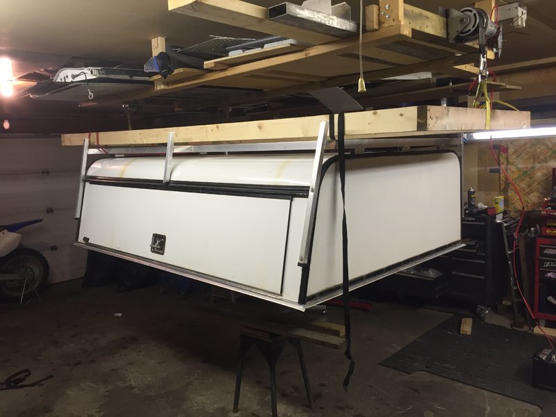

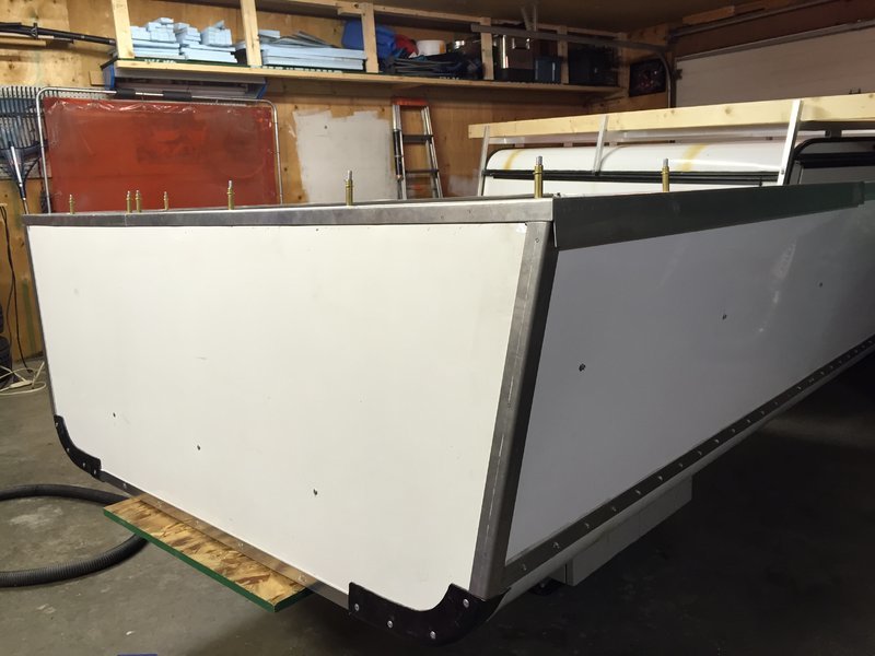

    My girl was strong enough to help me flip it over without destroying the drip edge so I could hoist it up. Im guessing the top half is a bit more than 100lb.

  20. Jan 29, 2017 at 8:27 AM
    #20
    WarrenG
    Jan 31, 2015
    #147585
    575
    Was Kind of an exciting moment for me when they came together. They will come apart again to do insulation
