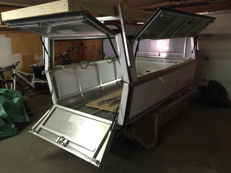

    The bottom door, how are you gonna work that out?
    I would say fabricate them so they swing out, because if it swings down you wouldn't be able to get in the bed easily. If it swings up it would be really high and heavy. :)

    I would also reccomend putting some type of seal here. Rubber of some sort, cheap door seals can be found at hardware stores. Otherwise transit is going to cause too much metal on metal flexing and it could end up squeaky or destroy all your hard work.

    I see now with your current photo.
    Maybe a little aluminum ladder and you'd be able to climb over the bottom door.

  17. May 27, 2017 at 4:05 PM
    #37
    WarrenG
    WarrenG [OP] Well-Known Member
    Jan 31, 2015
    #147585
    575
    So took your advice and made the rear door one piece. I decided to have it swing up instead of out to save reworking the existing hinge.

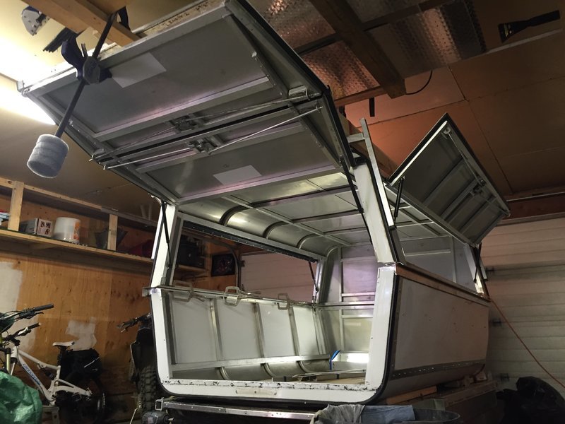

  18. May 27, 2017 at 4:06 PM
    #38
    WarrenG
    Jan 31, 2015
    #147585
    575
    Before...

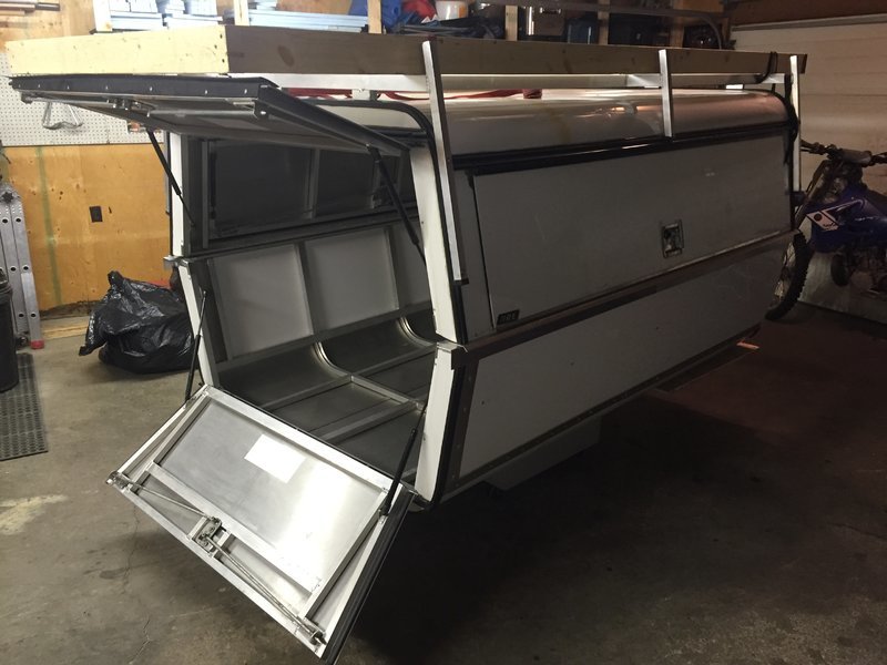

  19. May 27, 2017 at 4:07 PM
    #39
    WarrenG
    Jan 31, 2015
    #147585
    575
    After...
    Manfred, el topu, Nedrolls and 2 others like this.

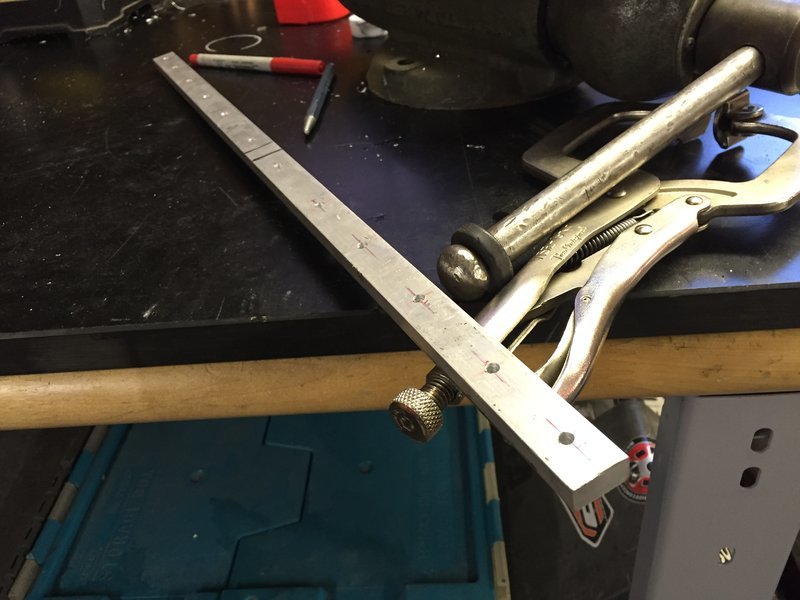

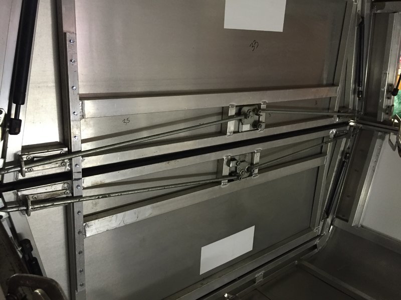

  20. May 27, 2017 at 4:12 PM
    #40
    WarrenG
    Jan 31, 2015
    #147585
    575
    TRYING to keep things simple, I closed both doors and joined them using some 1/2"x1" alum flat bar. Pre drilled the flat bar and installed with a bunch of #8 x1" sheet metal screws and removed the bottom hinge. Seems pretty sturdy.
    Hammerstorm and Chipskip like this.
