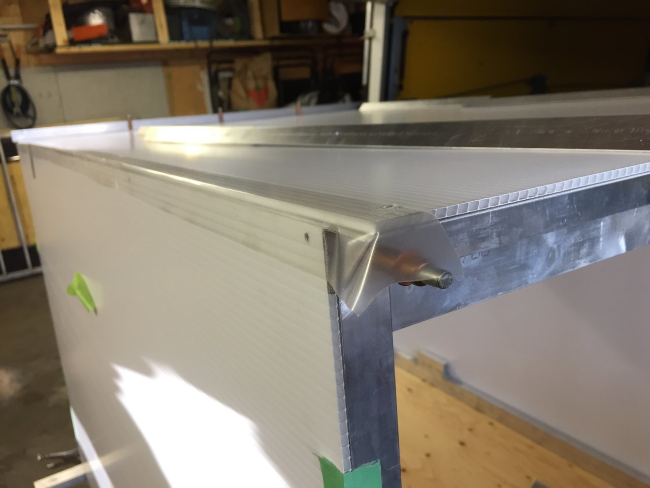

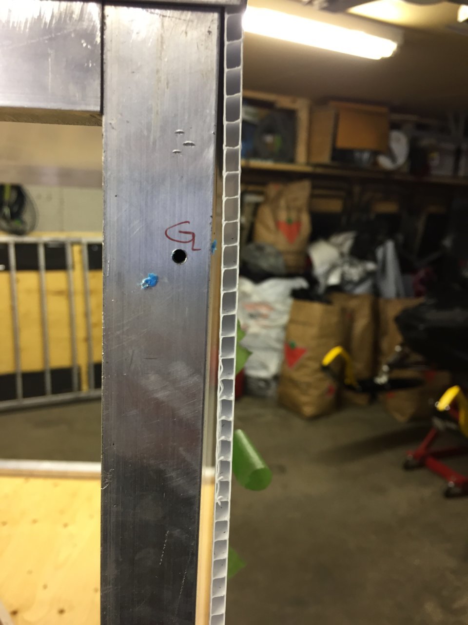

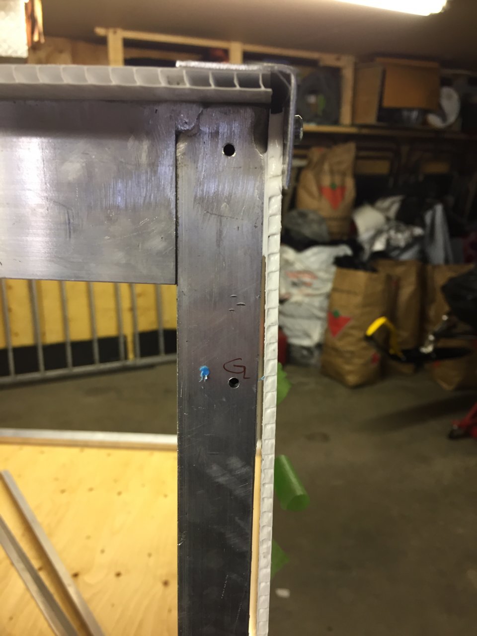

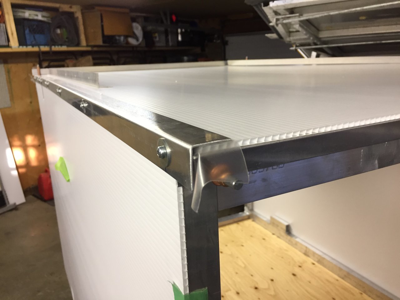

    Have the sign board panels all fit up and installing .060” aluminum corners. Going to tape the seams rather then using messy glue. If one of the panels gets damaged, I can easily replace it without scraping glue.

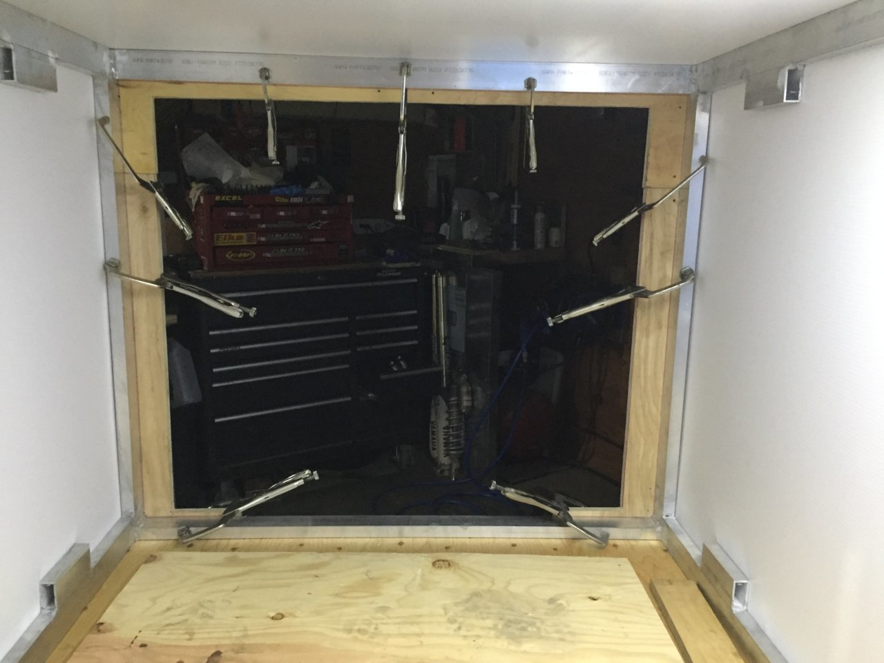

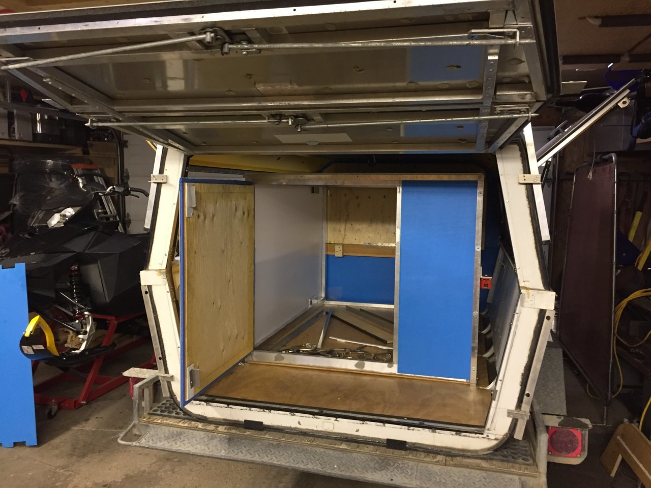

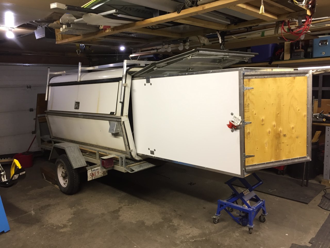

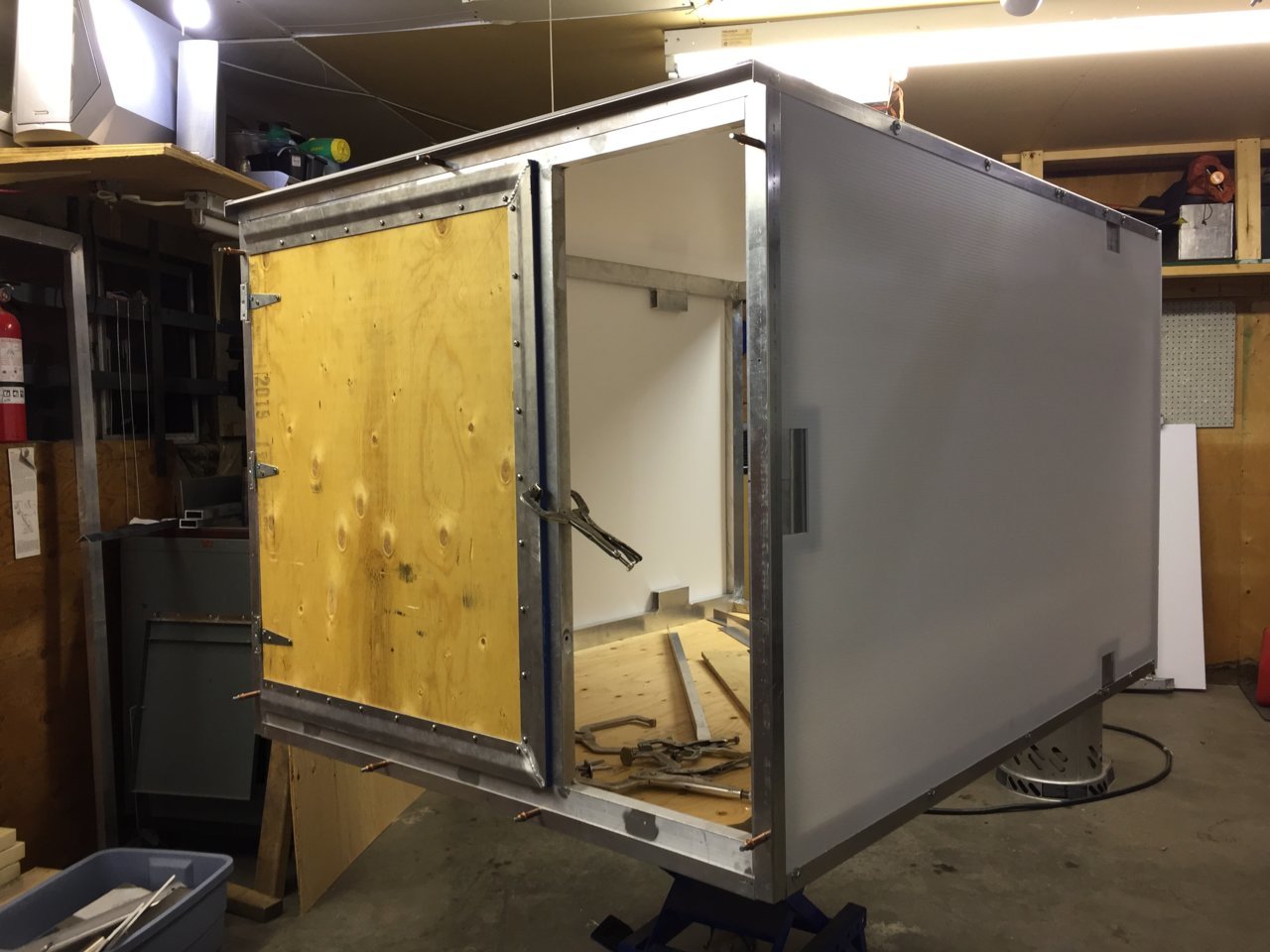

    Fitting up the reclaimed door from version 1. Lots of fussing around despite this looking simple.

  7. Jan 2, 2021 at 11:24 AM
    #107
    WarrenG
    WarrenG [OP] Well-Known Member
    Jan 31, 2015
    #147585
    575
    My friend had an interesting suggestion to seal off the ends of the hollow core sign board with caulking. The trapped air inside the board should offer a slight insulation value.
    Always love others input as everyone sees things differently.
    deanosaurus and POOLGUY like this.

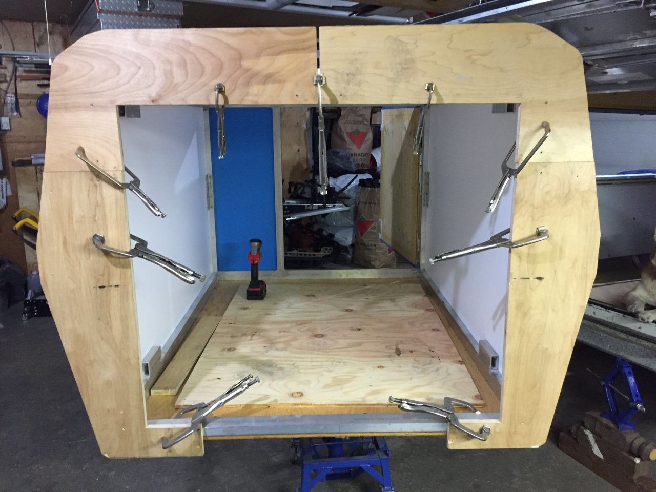

    Looks so much cleaner then the last one.

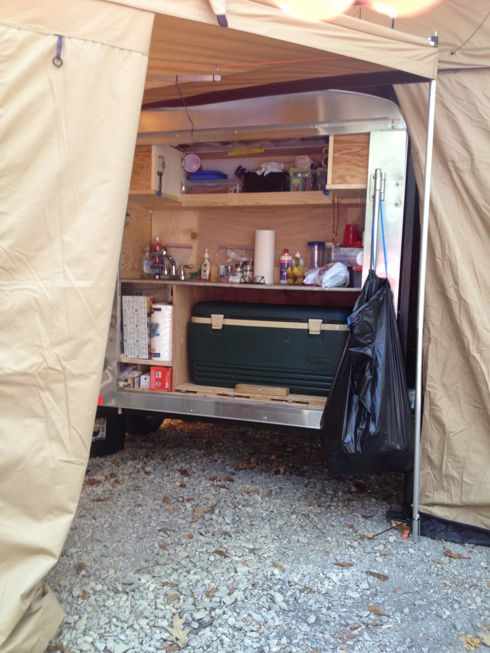

    I like it. Keeping it simple is sometimes the best way to go. My 5x8 enclosed trailer started off to be simple gear storage and a kitchen area. Now it is a mobile house. 27B74C27-D2C5-4453-9275-09369BC92AF2.jpgF00E3F4D-0A87-4EEA-A01E-B9906F15B034.jpg 8820F416-5A57-4174-BB24-46BC132C736F.jpg2A7E2C00-0F00-41EC-8446-33B83325882F.jpg

    Looks like you could sure hunker down with that set up. I like the cargo trailer idea, your kitchen is sweet

    the kitchen was the main thing for me. Camping is the only time I do the cooking. When we go camping I tend to gain a few pounds.

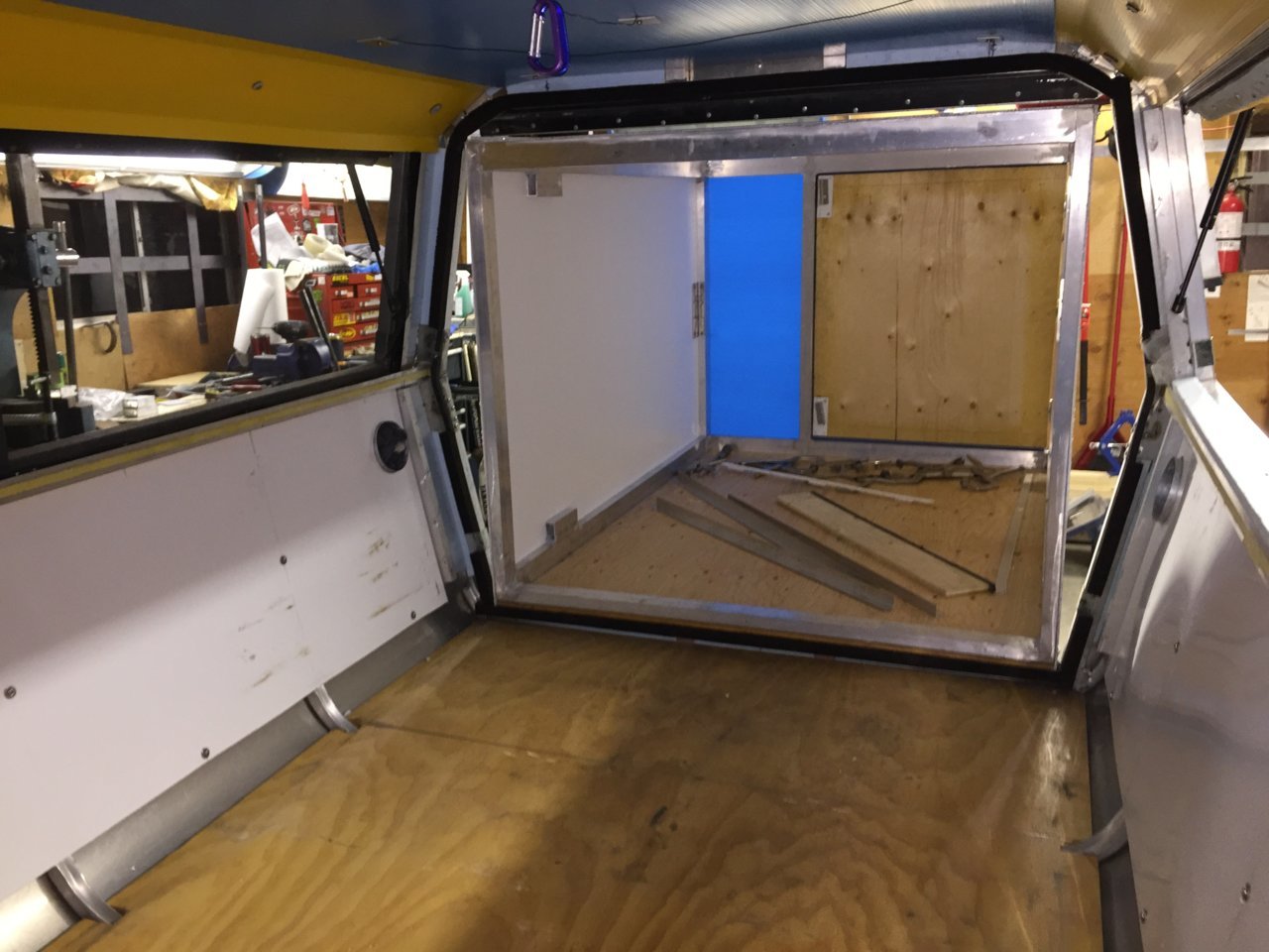

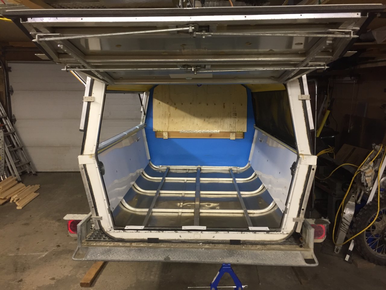

    Fitting up the reclaimed baffle piece, view from inside shows how much space was gained from the last version.
    Making this out of 5pcs saves so much fuss.

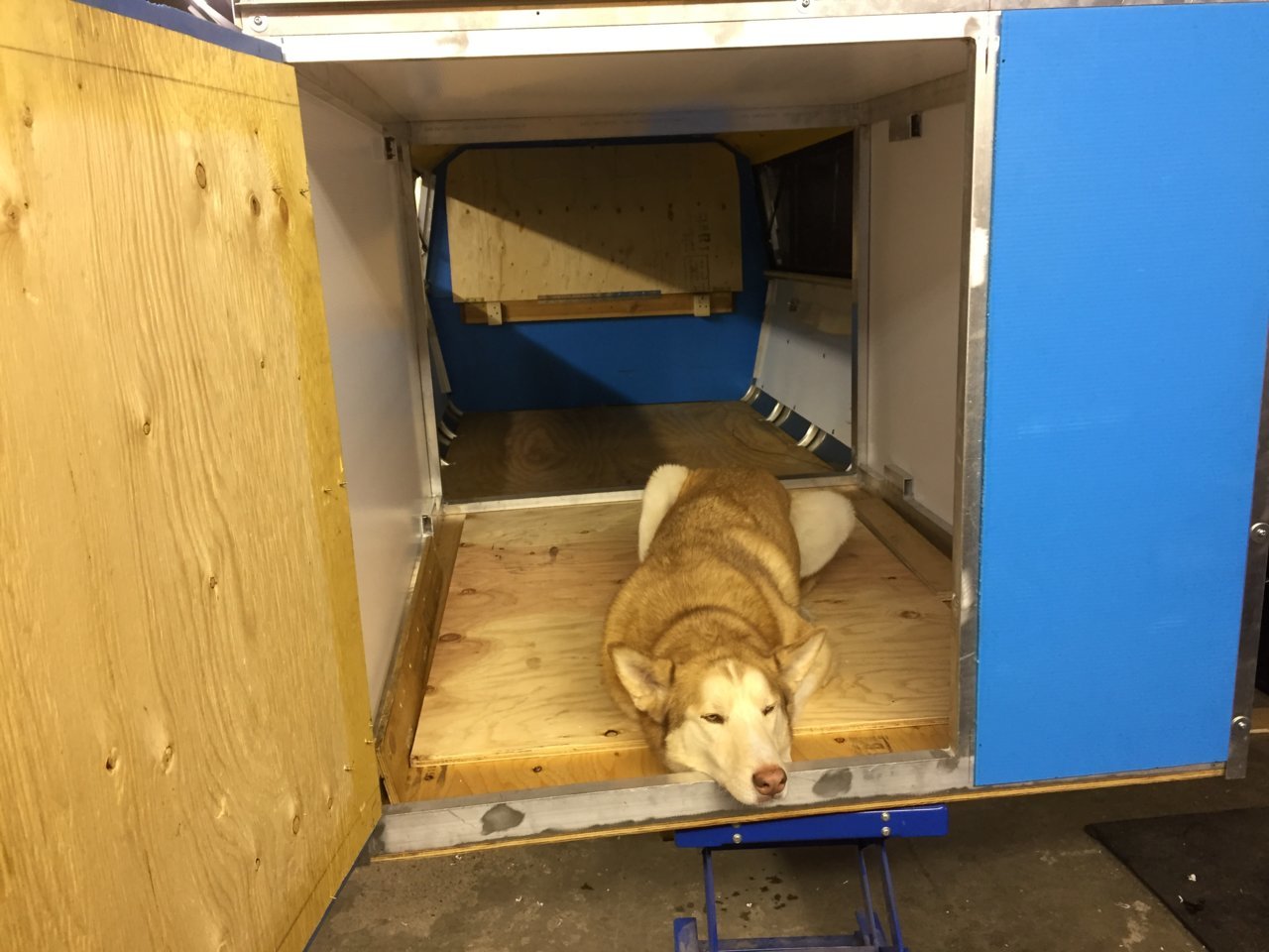

    Took some time to take out the floor and give it a cleaning.
    Dog approved

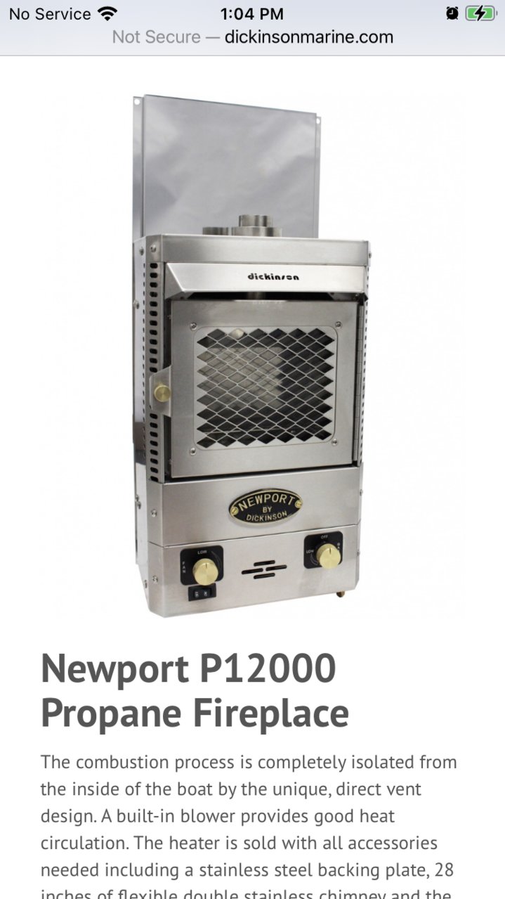

    Ordered this today, im pretty excited.
    thought about a diesel heater but I have convinced myself the chineese ones are junk, and an Espar brand one is $1400 CAD, which is fine but they have a lot of wires and connections, diesel is gross, and it requires power.
    Wasnt sold on the propane fireplace until I read it was designed and built in BC, Canada so the decision was easy

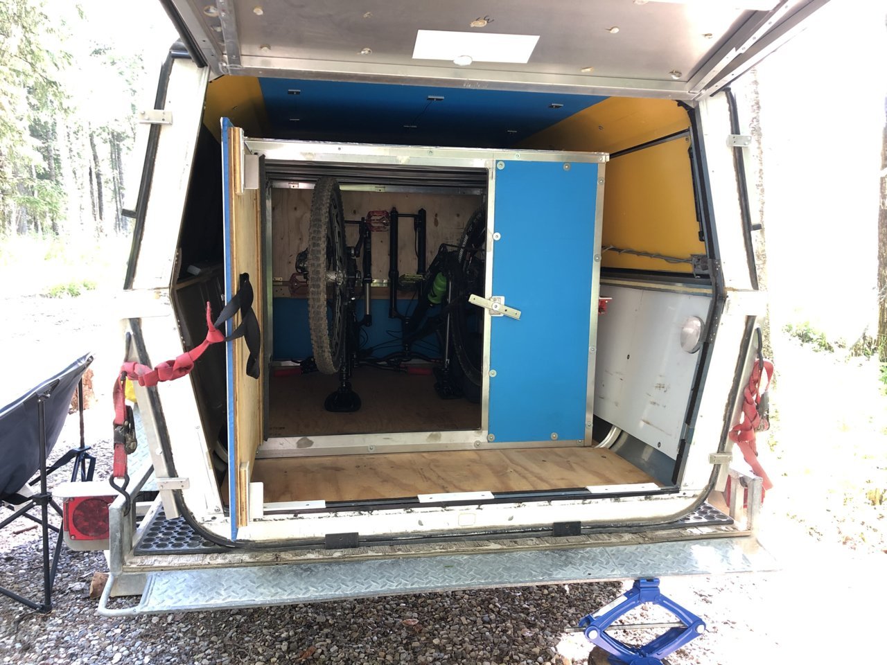

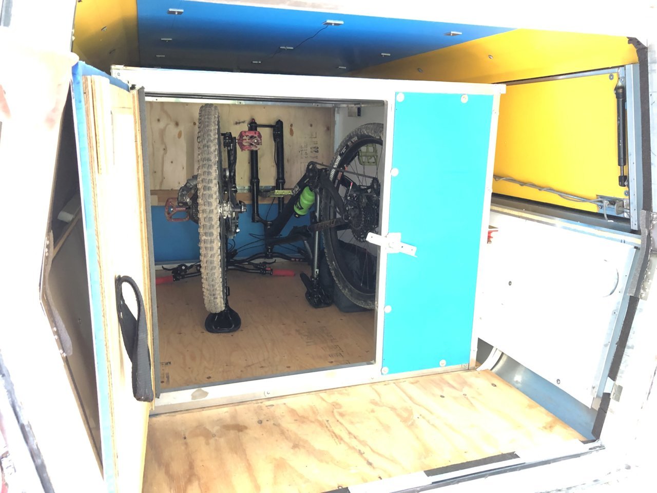

    One of the first goals was to get 2 mountain bikes inside during travel. Was forced to try it out this weekend and was pumped to find out it actually works.
    Turns out this thing will carry quite a bit of stuff.
