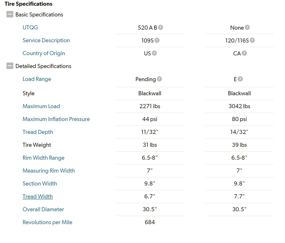

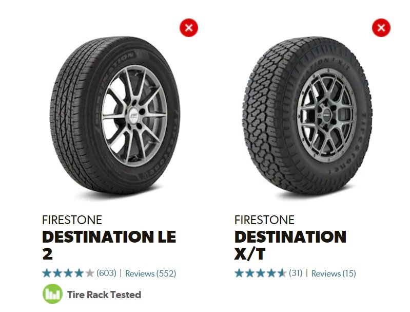

    Yeah, both of these are 245/75-16s but notice how the X/T is an inch wider
    JackJoachim[OP] likes this.

    True. Section width is the widest part of the tire measured in millimeters. But tread width is the part of the tire in contact with the road. The wider section width may not always translate into wider tread width. And it is not part of the tire size numbering system. You have to look it up in the manufacturer's specs.
    Tire weight is something many guys overthink. In this case 8lbs on each corner is nothing to be worried about. I've changed by 15 lbs on each corner and the difference was not noticeable.
    That said, I think 265/75/16 is the sweet spot for a Tacoma. That size is usually value priced, is just enough bigger to look good, but has no down sides. Going to 285's involves a lot of extra things to do, some negatives, additional cost and all for minimal gains in size over 265's.
