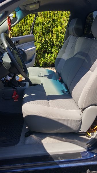

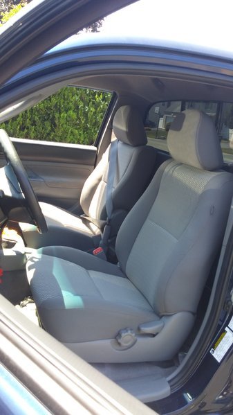

    Not same year as yours but this past weekend I replaced the bench seat in my 06 RC with buckets that I got from a wrecked 2014 extended cab. Took over 4 hours to do and I'm very pleased with the results, granted I don't have a console but don't really mind. Still got all airbags working properly...0723161057_HDR.jpg 0723161414a.jpg
