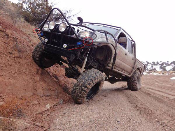

    Sick ass rig, exo should be closer to the body panels, tight is aight!

    here we go. Ford 9" rear after breaking 5 sets of gears in the stock yota 8.8, 5.13 gears with a detroit hard locker, 63" chevy leafs and custom hangers, sky's front spring hanger with sky's extream hysteer and PSC hydro assist ram and PSC pump. welded front spyders in the f-550 front dana 60 with warn hubs, pico brake lines and hoses, elecrtic fan, TRD supercharger with URD 2.1 Pully, URD Map-ECU2 and cage built by me. wide band a/f by inovations, lots and lots more...........
    well i did it with a harbor freight hand pump pipe bender so i got what i got. Im in the market to buy a computerized bender to make everything purfect.

    hahahhaa yeah its funny most people that talk shit seem to have a stock truck right off the lot lol never got any grease under their nails. i used DOM Tube. and iv thought about all the stuff you said but its my daily driver also soooooo i dont need bars going up my windsheild but i might just build some tube doors and the back isnt done yet or the roof. ran out of cash for more pipe

    the exo design is nice, and I do agree that the tube bumper is kinda "busy" looking.

    yes it is lol!!!! that was a trial and error before i built the cage and just left it. a 2am job that i got tired and went inside lol!

    I think if you redid that pre-runner loop in the front it would change the whole look of the front end. If you wanted to calm it down I would make that loop to mimic the outline of the stock grill.

    thought about it but iv used that loop more than once lol great for pushing trees over and keeps them away from my 8" HID's but the lower part of the bumper needs to be redone

    you see on the end of the bumper where you have the lower bar ending outside of the fender wrap bar coming in to meet at teh same location? If you wanted to you could have them meet at teh same location so when you take a hit on the lower bumper that force transfers into the fender wrap tubing making it stronger. As of now if you took a good enough hit it would just bend the outside of the bumper where that tube is. I would also think welding the end of the tube closed would make it look pretty good as well.
    If you wanted to change the look of the lower bar you can copy the lines I made or make it rounded to kinda match the amount of curves you already have on the truck. I personally like the curved and matching idea.

    that is what i was thinking/ money is tight for more tube so as it sits might be the way its going to sit for a bit. but i think we are on the same page
