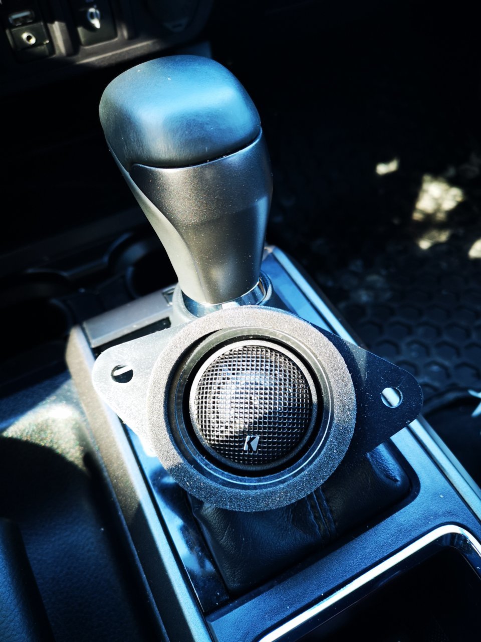

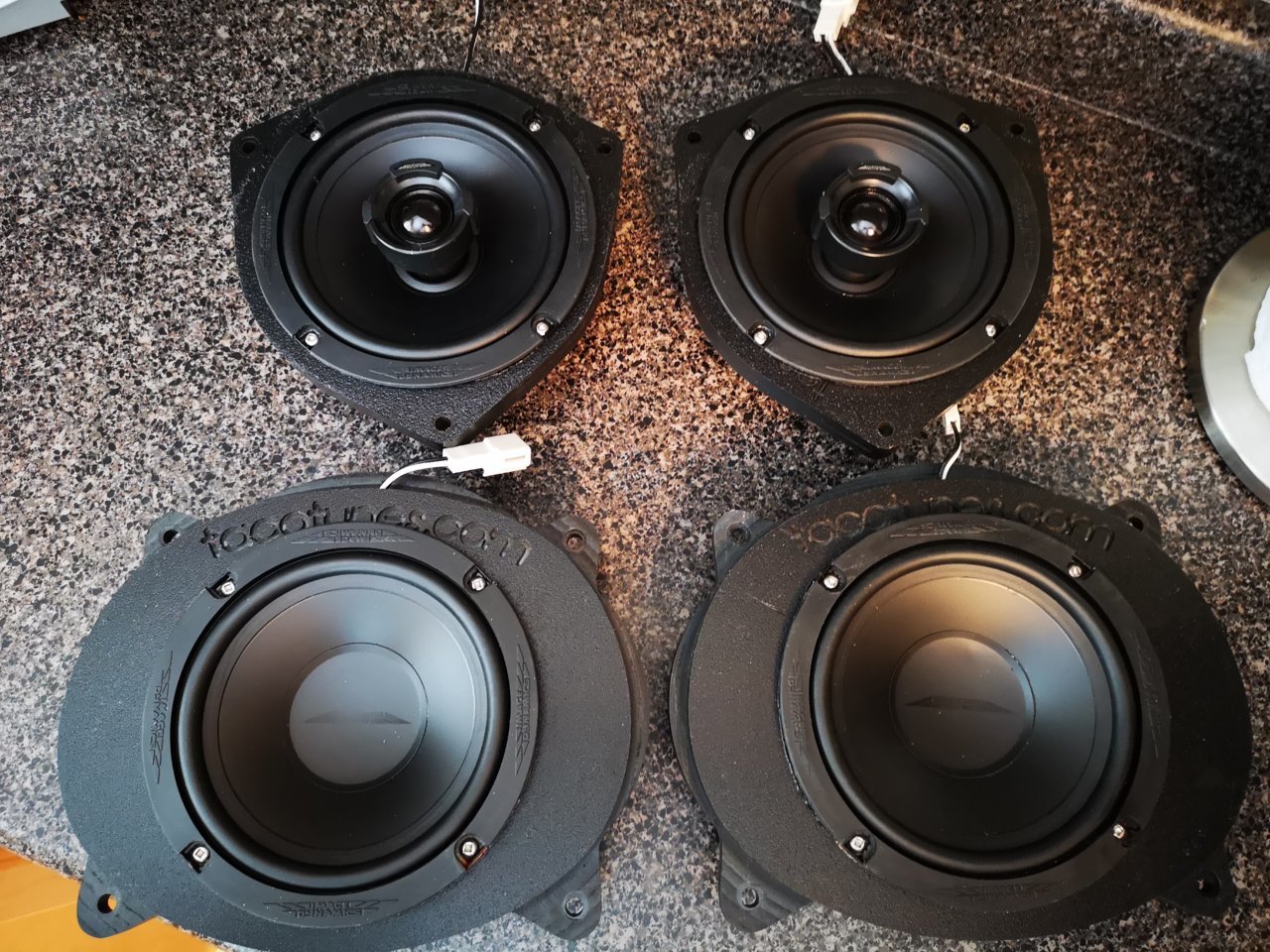

    Just purchased my 17 TRD Sport DCLB with Entune Premium 7" non JBL head unit. I removed my Taco Tunes speaker upgrade out of my 06, and installed it fit into my 17, perfect fit. Also added the Subaru tweeter upgrade, like others suggested. My question is.... will this head unit be able to connect a 3rd Gen OEM JBL sub to it? Is it a plug a play? Are the harnesses and plugs all sitting ready for this upgrade? Was lucky for my Ford FX4, hoping the same here. Cheers Al
