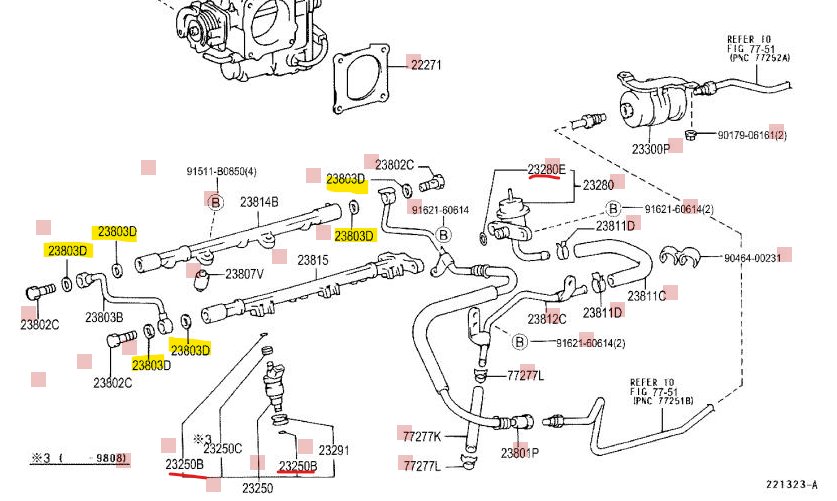

    Timmah! does a great job of specifying the required parts for a job in the description of his videos. But you can also find these things in the FSM or the Toyota parts catalogs:
    There are 6 crush washers. He also suggests replacing an o ring on the FPR, and I've also underlined the o rings for the injectors. It's helpful to get a few extra of those incase you fubar the installation of some of them.
