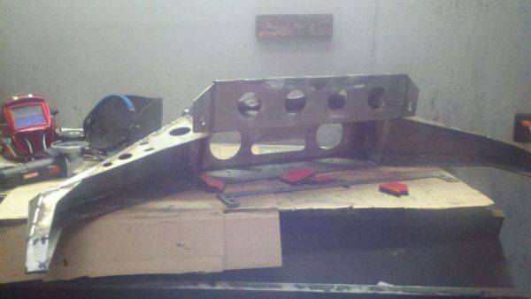

    If only you would have gotten it welded up a weekend earlier, I would have been able to come down and help you finish it out! but nooooooo, you gotta pick the weekend i already have plans for!
    cant wait to see how it looks. you went with a recon winch like daves didnt you?

    I just GOT the welder. Hahaha. I didn't want to be in a hurry and screw something up. Sorry man. I do appreciate the offer. As for the winch, I actually went with the Smittybuilt instead because I got a super-sweet deal at Autoanything. I like it because the control box can be remotely located if needed as well.

    Still have a bit of finishing touches, so I am not totally finished, but it is bolted on!!
