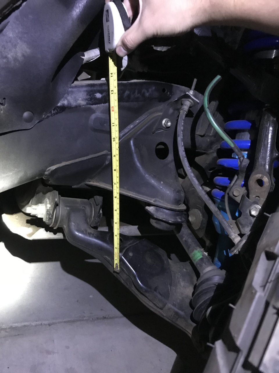

    so I’m getting some limit straps with an adjustable Clevis and want to know what side is best to weld my straps on.
    Option A
    It seems like the best option besides that the section of the LCA isn’t straight which might be kinda difficult in mounting my lower tab.

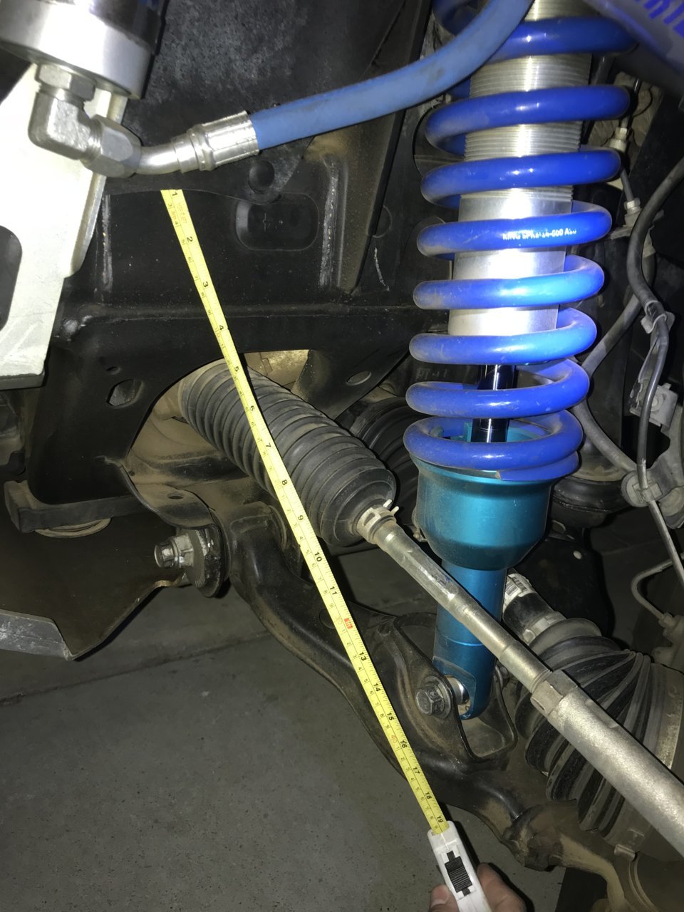

    Option B
    Mounting it in front of the suspension seems more ideal and better. Only concern would be the strap hitting the coils & tie rod
    If you have pics of your setup please post them or if you have better ideas please let me know!
    Reason why I’m getting limit straps is because my shocks top out when I offroad and it creates a weird thump noise when it’s fully extended so I want to rid of that noise.

    option A, for the same reason your brake lines and speed sensor wires are back there: more protected
