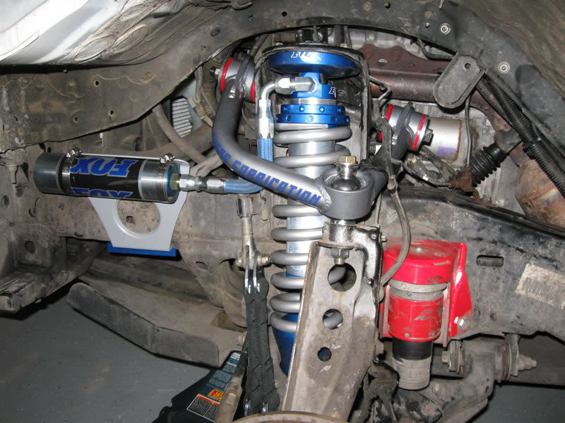

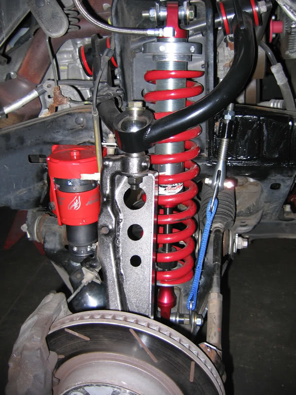

    heres a couple of mjp2s on his stock arms
    Looks like he has done the front and rear of the shock along with welding it to the lower control arm skid plate total choas offers.

    Mjp2s front setup is a great example for your idea. As for the rear you don't need a clevis. Just tabs and limit strap. Run your limit straps like shown above so they don't get caught on anything. I initially made that mistake too the first time around.

    hah! look what i dug up
    gues it'll work out alright. not i jsut have to choose what length straps i need...........oh, and color of course :rolleyes:
